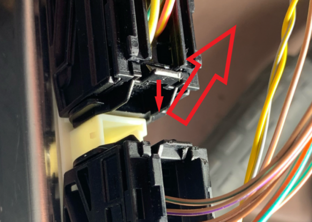

Looks like you have a tab holding it on the left side that needs releasing or squeezing; slide/pull that up?, circled here, then I take it that its meant to slide to the right and up at a 30 degree or so angle?
1,927
5,911
Comments in the DS video I found says:
"Simple 10 minute install, the module is in the trunk behind the paneling. Remove it, pull the 2 locking tabs for the connectors and remove them. Reverse process to install the new module. "
I assume that means pull "up" the tab I circled in red below?

ok how about this, pull the tab in the small red arrow out in that direction, then slide it the lock up. Then the connector slides out?
I take it the retainer has a tab that needs to bend out before it can slide up. Then the connector itself can slide out sideways?
It has to be like that. I’ll see what they show in the video tomorrow.

@Paladin06 it is easy. It is done by moving the BOTTOM of the assembly to the side, not the top. At that point it releases very easy and clips in even more easy!
I also hooked her back up, started it, flipped through the SRT Screens. All is absolutely normal looking. It never even knew we replaced the left side of its brains! Can’t wait to try it out.
I’m sorry, the bottom to the side and not the top?

Wow. Yes, slide the bottom of the connector to the side. Go disconnect your battery and try it! Snaps back on even more easy.
Seriously, there is nothing to do as I understand it. It gave no messages (good), and the screens are as they were and not changed (as expected).
I believe you can screw with it by computer, but I am probably not doing that part.
So far, now that we know about the connector, yes, it is easy to install.
