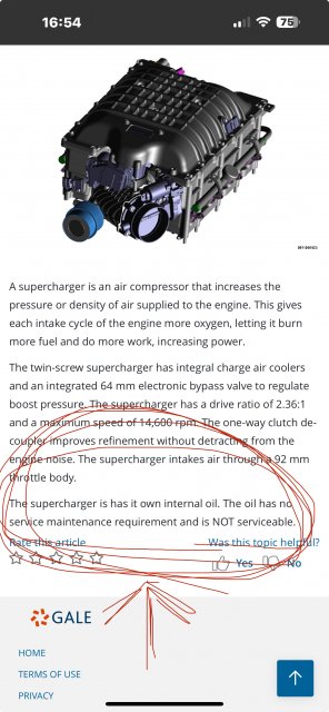

Dealer is hitting me up for a Supercharger oil change @ 15k miles?

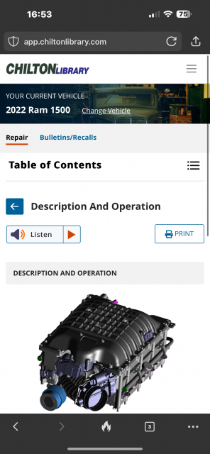

please let us know this dealer so i can call service and schedule mine

No oil lasts forever, however the oil in the IHI SC (Mobil Jet Oil II) should last a very long time.
Ask them for documentation that indicates that there has been a change to the S/C maintenance saying that the oil is no longer lifetime and now has the (ridiculous) service interval of 15k miles....
