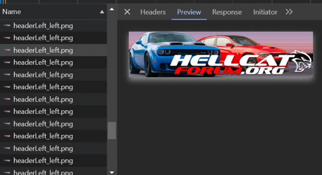

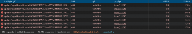

I have done a review of the network traffic. There is a slowdown in a few of the hops, that's something that the host and ISP will have to resolve, @HellcatFan already is handling that however I did a site profile. The site is DoS itself. You have a few redundant calls.
This endpoint is taking the server and bending it over. Not to mention there are multiple redundant loads of images:
I'm not saying these are the issues but fixing this might go a long way on server response times. The header was loaded more than 20 times easily.
There's your answer.
