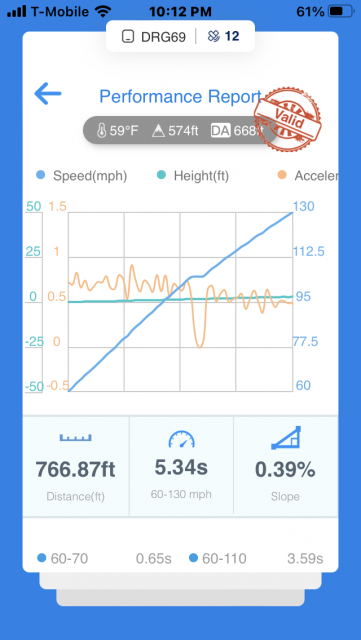

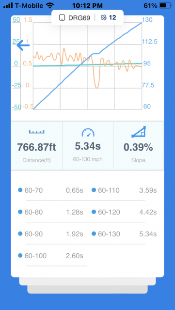

@16GoManGoHC2 what’s your fastest 65-110?
I’ve only been doing 60-130 pulls, fastest was a 5.34
60-110 3.59
Why?
4339FD3A-F63E-42B0-951B-651202A4764C.png 66DC8466-337A-4C57-9B3F-3E6177831DA4.png
Haven’t tried with Whipple and ported heads yet though. Waiting on a Satera clutched pulley for my Whipple

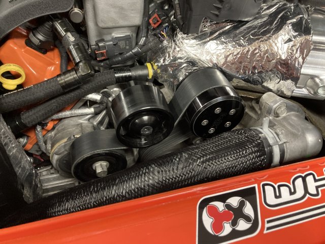

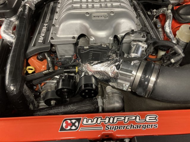

So far my 2.74 Rings if Hell pulley driven by a +10 ATI lower is performing excellently. Added the AAD idler and no belt dust what so ever and still clutching like the first day of use. You can tell on shut down how well it’s clutching as the blower whirls down for 2-3 seconds after shutdown and sounds cool as hell lol. But I’m going back to my Whipple soon, it was almost a second faster in the 60-130 and I miss that power level, 5.25 60-130 with a stick is just crazy fast, LOVE IT!! Maybe with the ported heads and new rubber the 3.0 can crack a 4.x something. Hopefully Satera has a Clutched pulley out for it soon as well.

Close up of the 2.74 Satera pulley with the AAD idler.

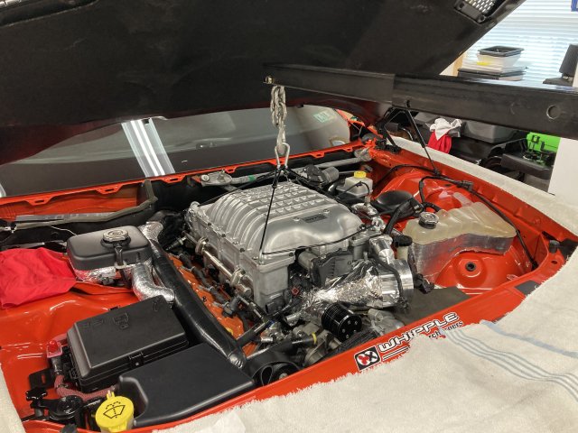

Bye bye Mr 2.4, it’s back to WHIPPLE TIME today (literally, just wait and see the time difference)

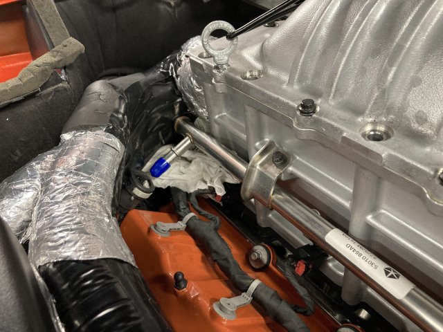

How to keep the fuel mess at bay, have a cap Ready and waiting
And cover the fuel line with a small plastic bag ASAP to keep the crap out of your injectors
