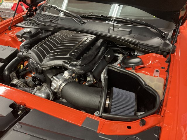

Any pics of the intake tube? Still curious on that
In the box yet, dont plan on using it, its smaller then the JLT. I’ll take some pictures of it tomorrow. But here it is on the reveal pics.
Looks pretty big. Surprised it is smaller then jlt
It’s the tube that’s concerning, like the TB adapter it’s sized for the stock TB. The JLT matches a 105 perfectly.
Could be because your kit is a stage 1. The stage 2 comes with the 112 throttle body and the intake looks the same size
Or the JLT is just bigger and they use the coupler to neck it down
Your probably right on that, makes sense. Be getting busy soon. My HHP 105 came with a size for size sleeve That fits perfectly on the JLT and its throttle body and looks almost exactly like the picture you posted of the Whipple 112 set up
You should show pics of both with measurements:)

I ended up having to remove the JLT air box and snout and filter, would not work with the new position the TB ends up at. In the process of installing the Whipple air box I broke the motor actuator off the top of my chiller drag valve 🤦🏼‍♂️ was mounted to the valve with a plastic bracket. I had to massage a step into bottom of the Whipple air box with a heat gun to clear it, what a pain, Now I’m going to have to machine a new bracket out of aluminum or something so right now my chillers in drag mode only which is no biggie. This morning starting on the fuel bumps and then hopefully I have a belt that fits and then test ride hopefully :).
7296CCF5-3A71-4DFC-9361-89038B0745EA.jpeg F4E306CB-C9B9-4F99-BB86-1B915E9EF0A5.jpeg DA03705A-43C2-46B9-A94E-B1660FD3654B.jpeg The snout was actually large enough and was a perfect tight fit over the inlet of the HHP 105 but then wasn’t long enough to make it to their air box so I had to use a silicon coupler but then it all fit. The insulated lines hide the valve cover covers which do fit back on using the stock fuel rails. It’s all close to the hood, no way any thicker insulators could be used.
