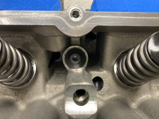

Ok, had a detour back to the block. After all this meticulous work on the short block and now the heads, all the time spent cleaning everything up to like new a thought that kept me up at night was those beautiful pistons with exact to the thousandth rings and exacting bearing clearances crashing into the hours spent on valves and heads on start up so I had to degree check the cam installation. Been a long time since doing this and this HUGE 123 degree lobe separation and VVT grind made valve events not look right in relation to piston travel location verse valve timing events but it ended up matching the cam card within a few thousandths and a 1/2 a degree which could be instrumentation alignment errors. Ready for the heads now and peaceful sleep!! View attachment 47563 View attachment 47564 View attachment 47565 View attachment 47566 View attachment 47567 View attachment 47568 View attachment 47569 View attachment 47570 View attachment 47571
Was wondering about this a few years back when VVT became a 'thing' on new engines and I still had my solid roller, straight up, big block Chevy. How do you even degree one? I guess it's all done 'straight up' before the hydraulic magic movement kicks in. I never did a VVT motor so I wasn't sure if the cam was locked into position mechanically then altered with hydraulic pressure or if it just 'flopped around' until start up and then the hydraulic pressure would immediately place it where the computer told it to be. If it was the latter I didn't know how degreeing could ever be done. Now I see the spring cup thingy holds it until hydraulic pressure fights against it and rotates it accordingly.
Yep, I had the same wonders. You just check it straight up like you said to make sure it’s installed as intended and the computer takes over from there once it has oil pressure to do so. Speaking of oil pressure thats why using stock recommended viscosity is important and I kept the main and rod bearing clearances tight for use with such thin oil. Your right on target with your thoughts on how it works.

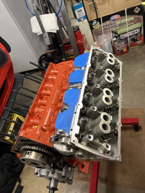

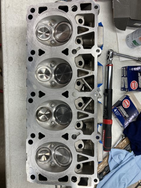

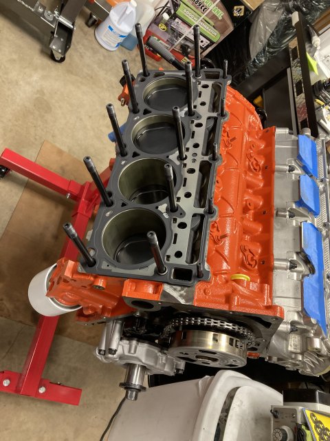

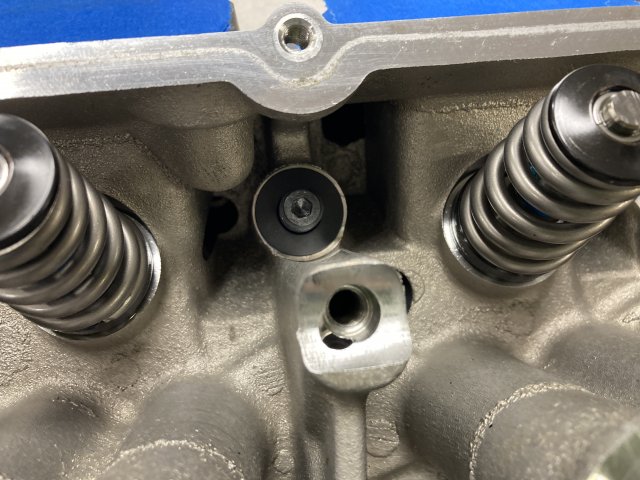

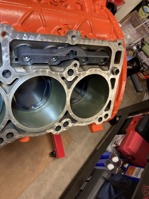

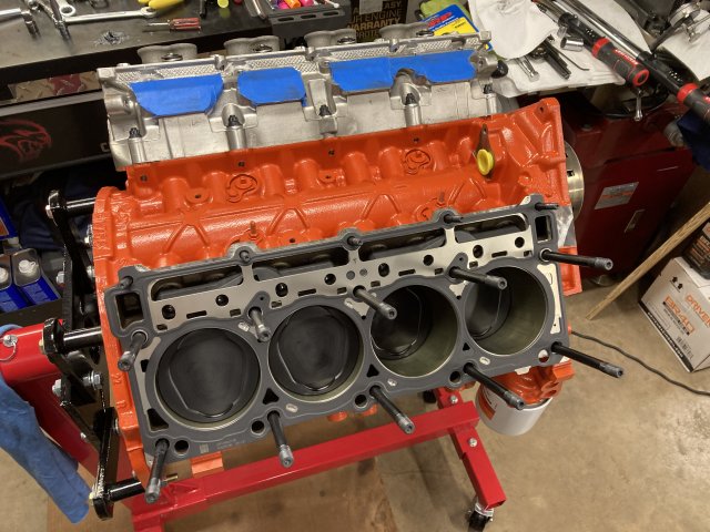

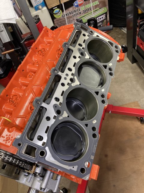

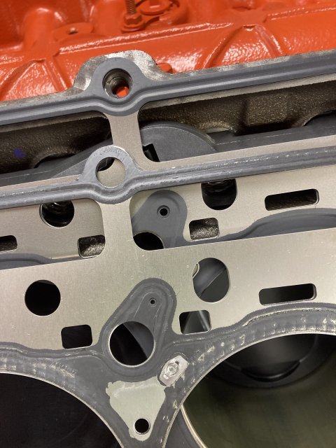

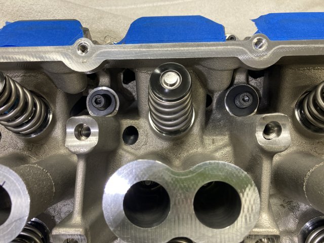

Ok, back on track here. So after being happy the cam is installed correctly time to make it into a long block and cover up them pistons!! After another application of Total Seal Quick Seat dry lubricant to the cylinder walls set #1 down a bit to get all pistons away from the heads for when rocker shafts and stuff are put on time for head one more thorough cleaning and time for head gaskets!! Take note to original 15-17 head gasket verse newest revision head gasket oil control orfice has been increased in size from .062” to double that size 118”, times 4!!! Wow that’s going to be a bunch more oil going up top to lubricate and more so cool the valve train especially the springs. Also notice the spark plugs are installed and indexed toward the intake valve and center of cylinder. This helps to cool the electrode and also keep it cleaner verses it being shrouded by the ground strap and in the shade per say of the cool clean intake charge. This helps flame propagation and travel and also detonation resistance by cooling the ground strap and electrode tip. I also installed the plugs with no never seize, NGK recommending against its use that it’s application can alter a plugs heat range characteristics and cause detonation as well. The silver color coating on them is supposed to be a anti seize of some sort built onto the plug. C86C13C3-066B-4905-A4DA-EC01009B74BA.jpeg 6930E681-6D27-4930-9640-CD6DB9646523.jpeg 5A3B2327-0961-4865-A19B-45BC93C015AF.jpeg D1CA8820-07B7-4B70-B22E-BDAB6977C3E2.jpeg
3,690
8,707
Thread Starter #300
Bye bye pistons, hope it’s a very very very long time before I see you guys again, never will be fine by me!!

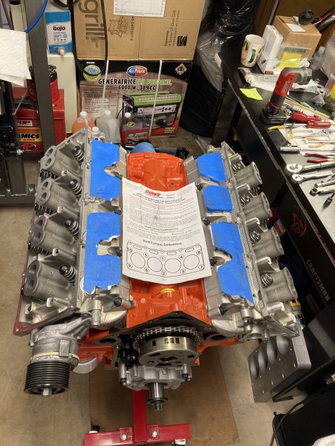

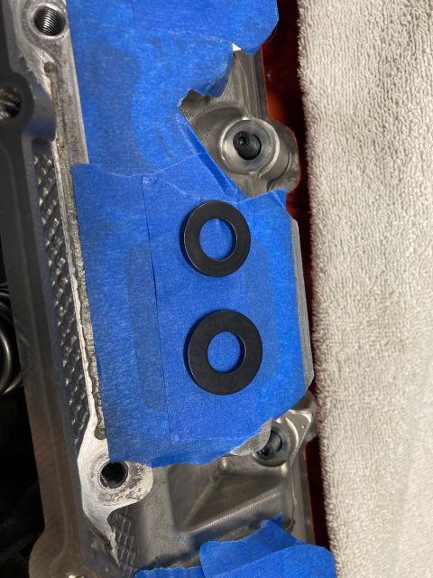

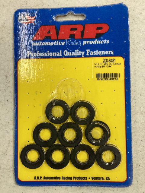

Word to note when using the ARP head stud kit. The washers in the kit are too small for the head, the ARP bolt kit comes with the right washers but the stud kit doesn’t, weird. I brought it too ARP’s attention when ordering the correct washers so hopefully they change the kits to the larger OD washers in the future. Tq’d in 4 steps 25, 50, 75, 112 ft lbs, 7 more then recommended as I’m not going back in to retorque after a heat cycle.
Next up valve train!!! And test timing one more time before putting front cover on and balancer. Hopefully get to tackle that today !! 🤞 F753BBCC-9BBD-4B4E-B46F-F9BBE66FEFF3.jpeg 3E4EDB04-A4DA-4EBB-B324-AFA8CF5489D9.jpeg 8EA06CC8-06C5-48FC-A2F9-EA65922DD4E6.jpeg E0A46AF0-354E-4DF1-9B24-6E6C8B884BB4.jpeg 70F05F10-1457-47D3-A09B-5131B7404B6A.jpeg 8EC4A5C1-29A4-40DC-B3B2-FB296D970AEE.jpeg 3819BE51-116B-4AD6-A452-0ED46D3EC2E1.jpeg EEFE319D-26DD-4A0A-B9A4-AA3F4BCA3C5A.jpeg C12969B9-572F-4A6E-8F40-47A16039870F.jpeg 64D7582D-9763-49BC-B706-6F6C57002604.jpeg
