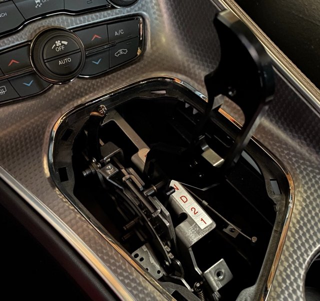

Back to work!! Manual ratchet shifter is in for the T400. 8D552AEA-C76C-4BAF-B250-E5735C4BC9E4.jpeg

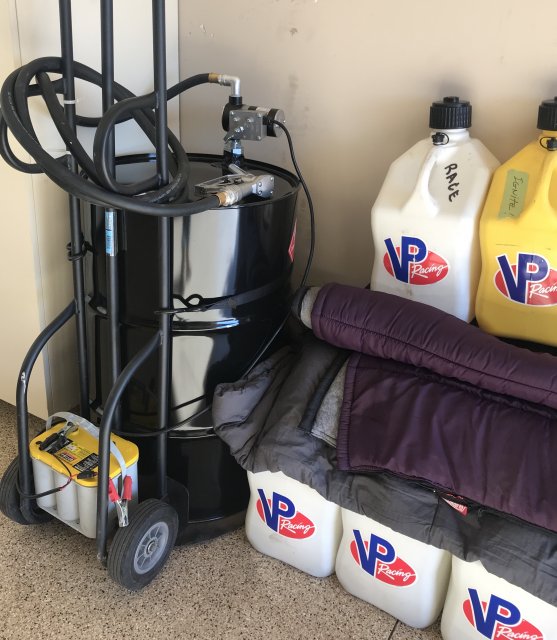

Gas station in my garage 🤫. 55gal drum of Ignite E90 with a 12v pump for when it’s time to go 155A77D3-3FBC-43E8-A48E-0614ED67B271.jpeg

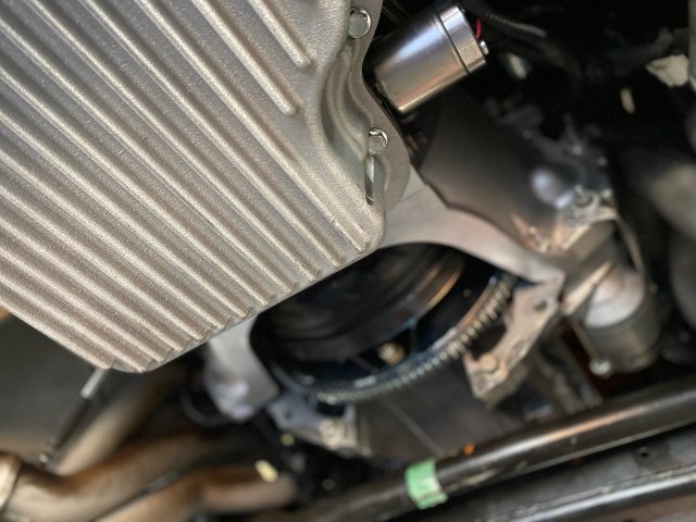

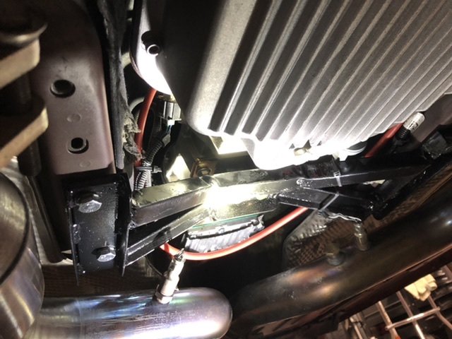

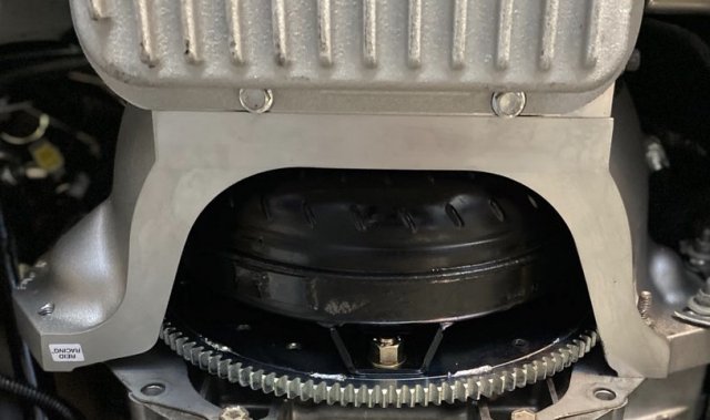

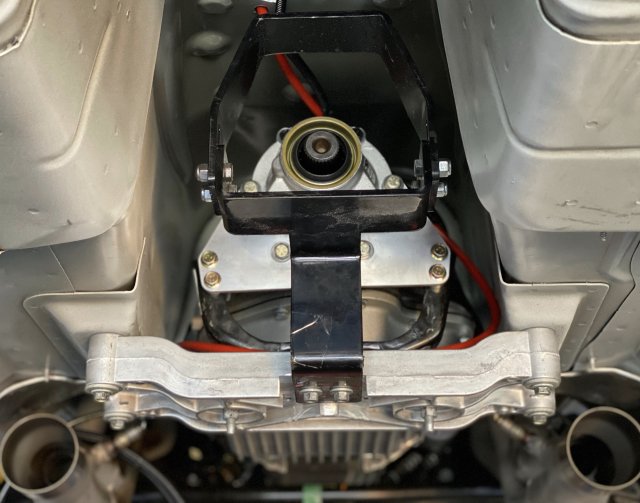

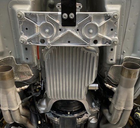

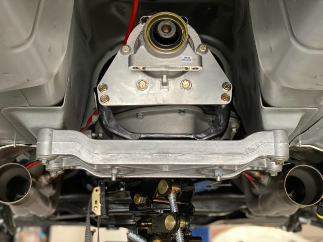

Coan Engineering T400 is in. Thanks to Micha at OST for his help. The complete package as it is available makes this a very simple mod. All of the decisions regarding what is needed for this have been put together and for the most part it is bolt in. Kinda like a CAI. 😂 Here it is as of today.... 681E3E2C-BC05-4C3D-8782-71EB7F0794F9.jpeg 84F30BC1-C1B4-484E-BAB5-C77B6C2821AE.jpeg 24593679-0EE6-47E5-A4A6-68C3D0AA07AE.jpeg 2089C12F-9C93-4754-B93A-CEB89EA133FE.jpeg
3,624
11,682
Thread Starter #170
And btw...... it’s 60 lbs lighter than the A8! :cool:

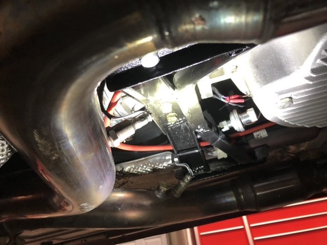

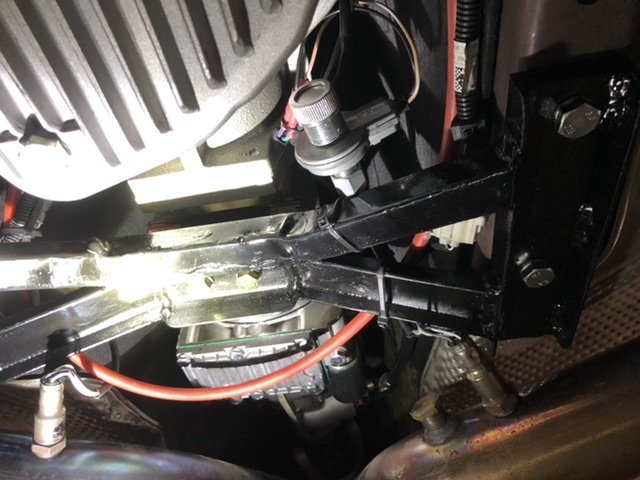

I got the rear mount and wasn’t happy with the movement just FYI
Hmm 🤔. I see that you have a custom crossmember but can’t see how that attaches to the trans. Mine is a OEM manual trans crossmember and mount that attaches to that custom OST plate on the trans. That seems to be a pretty solid way of using the OEM trans mounting structure to keep it in line. Have you had a unstable situation there? What was the problem and have you addressed it?
It attaches at the two mounting holes in the tail shaft housing using a stock GM mount.
Put the trans in and didn't like the rpm being so high when I just wanted to take it on a cruise I have 3.70 rare gears so I added a gear vendors OD
witch made my driveline a lot shorter so when I put my driveline loop in I used the stock carrier brg location
only gave me about 3/4 of a inch clearance didn't want to take a chance with the carbon fibre driveline
