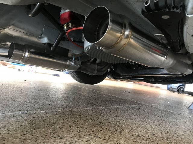

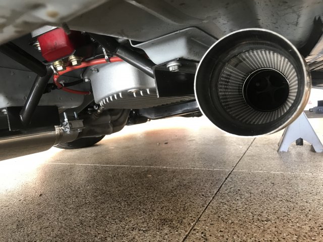

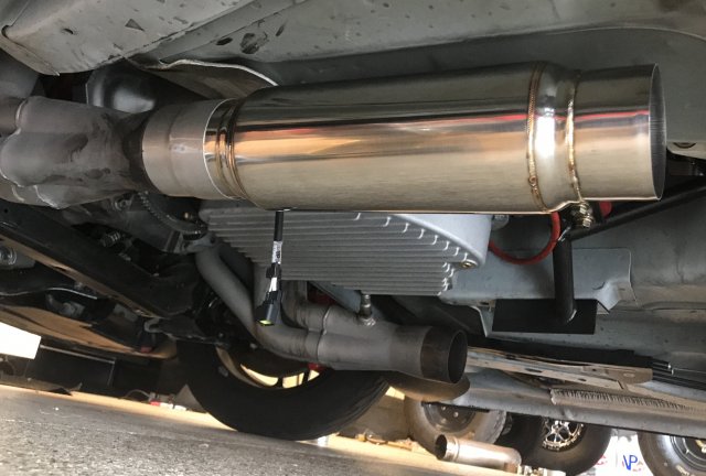

Getting ready to get this thing on the track next week and I have her home doing a few things. The new rear suspension required a change with the exhaust. I tried just eliminating the mufflers all together and it sounded real good. But setting off car alarms in the neighborhood when just warming it up in the garage was pissing my wife off. So to tone it down a little.... I’m doing this. 3.5x14 inch polished stainless “Race” muffs by Kooks. Definitely the most beautiful mufflers I’ve seen and at $54 ea...... wtf? How is that possible? 4832AB2F-A996-40CF-8C27-0518F74F0F66.jpeg
3,629
11,708
Thread Starter #689
Plus/plus...... knocked 40 lbs out of the car from what I was previously running with the big Flowmasters back at the rear axle.
Getting ready to get this thing on the track next week and I have her home doing a few things. The new rear suspension required a change with the exhaust. I tried just eliminating the mufflers all together and it sounded real good. But setting off car alarms in the neighborhood when just warming it up in the garage was pissing my wife off. So to tone it down a little.... I’m doing this. 3.5x14 inch polished stainless “Race” muffs by Kooks. Definitely the most beautiful mufflers I’ve seen and at $54 ea...... wtf? How is that possible? View attachment 37994
They look like vibrants. You could always take them off at the track too .
3,629
11,708
Thread Starter #691
Yeah, easy removal but...... I was told that the front O2 sensors need some back pressure for tuning and 24 to 36 inches of length past the collector or a muffler to provide that is necessary. These things have virtually zero restriction and probably minimal sound reduction, but should take the edge off.

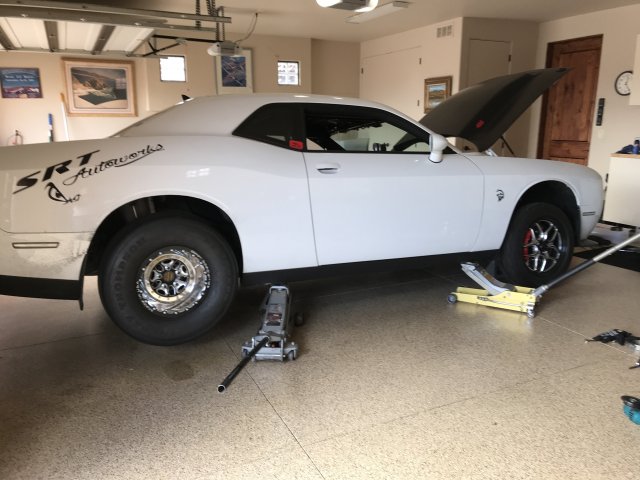

Working on the garage floor sucks! Running a little ragged without the rear 02’s and a crossover. Either need to turn those off and retune or put them back in past the muffler. I’ll be on the rack at the shop next week and the new dyno is up and running so everything will get sorted out. B1FCC917-C927-41AD-A71E-B74BB77F96AC.jpeg 8F2954EA-39A3-4361-8EFD-F1294B1123EA.jpeg A64B560F-8CB9-40B2-A576-D94BA2671D33.jpeg
I turned my rear O2's off long ago .
3,629
11,708
Thread Starter #694
How does that affect the tuning? Any considerations because of that or like it never happened and why were those things even there?

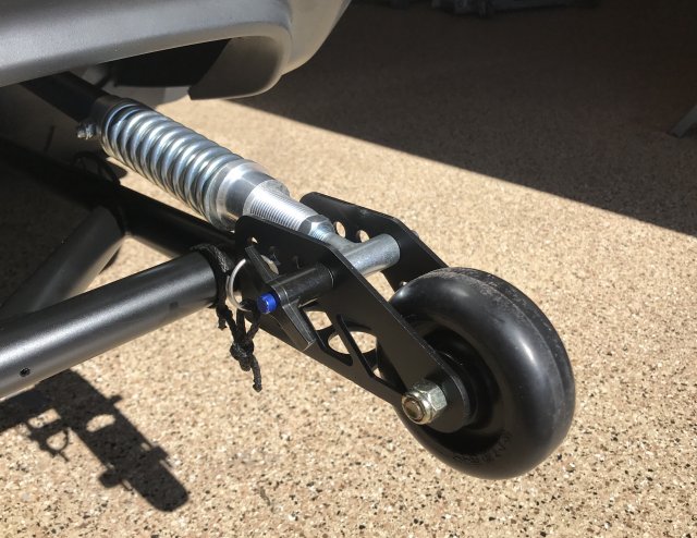

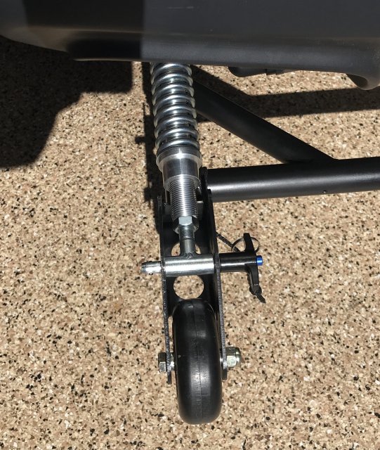

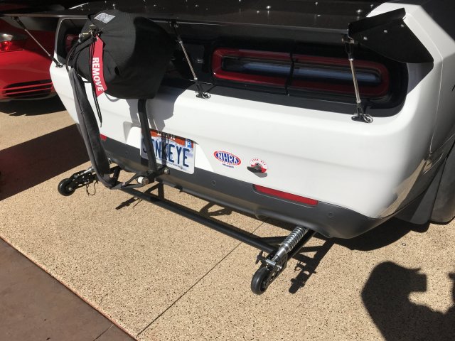

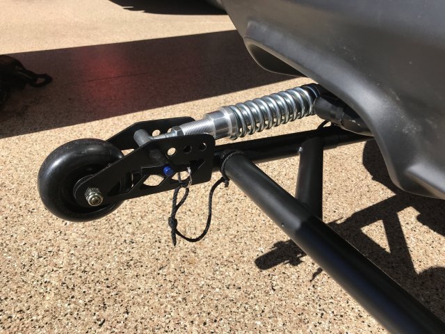

Finished and ready for work. Beautifully done Chromoly MPR DragPak wheelie bars are a work of art! 66B4E305-9082-499E-91BA-ED677A757CE5.jpeg 7E3028B6-CADC-4B04-BA72-907210FC5254.jpeg 5B44CD71-B126-4BC5-88B0-640C39E8B554.jpeg 4EC84E4E-2CDE-423A-8320-520D0C652BD7.jpeg

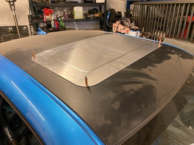

Thanks. I will be ditching the sunroof when I’m in for the 7.5 cage update. Just considering my different options. The shop doing the chassis work just did this to another sunroof car. They said they pulled 50 lbs out. BD6F4C70-E5FF-41A4-9768-4F20F67C38F0.jpeg

Ya you have gone this far might as well ditch the sunroof. Car will be lighter plus no sunroof looks better IMHO.
