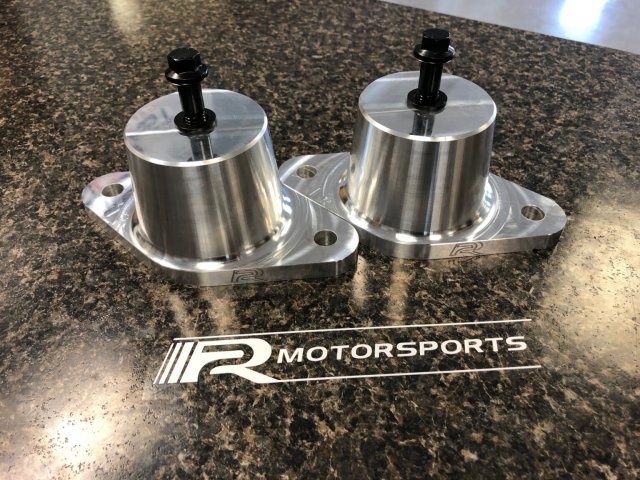

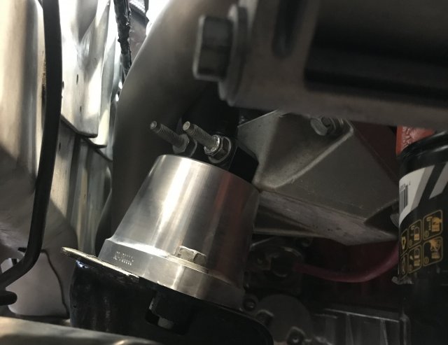

Has anyone here installed R2 Motorsports solid motor mounts?
If yes what are the pros and cons?

Supposed to transfer a fuzz more power to where it counts as long as you don’t mind the vibration.
