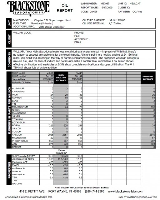

Just got my latest oil analysis report. Just under a year in the crankcase and using, dare I say it? A non MS12633 oil. Mobil 1 for the win in my book.
Any chance you sent in the factory oil at your first oil change? What did they say? No break in adders correct?
I really wish I had, basically I drove it home and changed it as soon as I could. I didn't like fact it had been in there for a year and halfish and only driven 700 miles. :mad: But it was low, even with the drain from the oil cooler it was just shy of 5 qts.
I ran across a UOA on factory fill (think 2016 Hellcat) and didn't have any indication of break in adders... but may not be finding if different from moly or boron, etc. Who knows?
