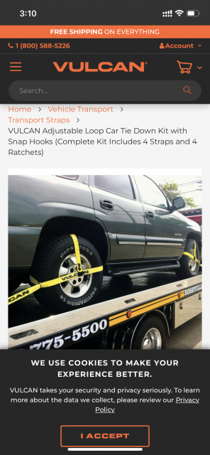

A basic lasso strap, as shown in DGatzby's photo earlier, doesn't care how small or large the tire is.
Usually there's no need for the vertical support shown in the Vulcan photo above.

Normal lasso straps is what I generally use, more often than wheel nets.
Either over the tire like DGatzby showed, or with a fuzzy sleeve through the wheel. All depending on where the trailers' anchor points are, and what vehicle it is.

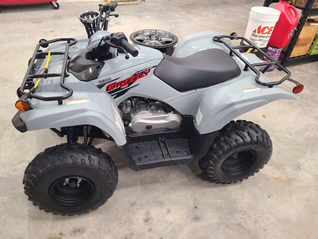

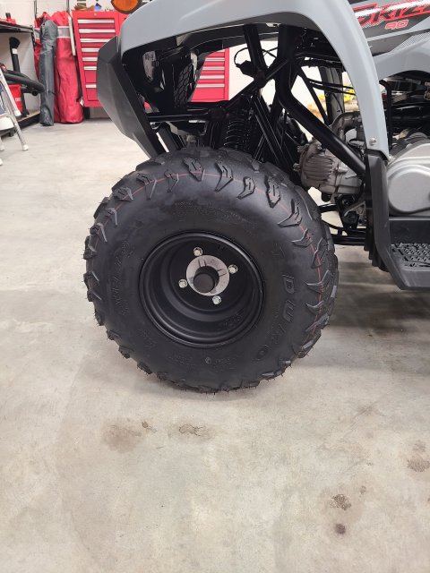

It has solid wheels so that's not an option. It's a baby Yamaha Grizzly used as a pit cruiser.

I kinda sorta remember the photo(s) you posted of that. Could you repost and I'll put my thinking cap on?

If it is smaller ATV shit just tie thru the wheel and pretend it is a motorcycle.
Edit… I just was reading your solid wheel problem. Damn it David! Then buy new wheels!!

I looked. Not worth the money.

Yep, get out the motorcycle tie-downs and grab that frame anywhere.
Very close quarters.
It sits between the Charger and the cabinets. It can't move more than a couple of inches. It's already scratched 1 cabinet door.

With those tires you could use a strap over the tire, or a lasso strap either as in the Vulcan photo, or as DGatzby uses his. If there is room to get to them that is.
