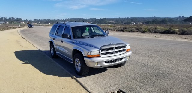

Guess my Durango is AWD with 4x4 vs just 4x4? Not well versed in these systems.
I'd say that it's the other way around. It's a 4X4 with full time capability.

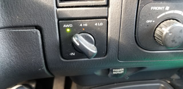

Here is my Durango switch. Guess it is always in AWD? Bought it to flat tow and didn't realize AWD until after the fact.
Excuse it being dirty.

Not always. Not if you put it in 4Hi, 4Lo, or Neutral, right?
Can't remember if putting it in Neutral made it flat towable or not, but I don't think so.

Actually yes, putting the transfer case in neutral allows for flat towing as per owners manual. One shop made a statement about it being AWD and more complex...but I don't know. Bought at 88,500 miles now at 104,000 miles. Been a great adventure car on our camping trips. Actually love driving it (not as much as Hellcat though).
5,847
38,248
Probably have flat towed it 12,000+ miles.

What year is it?
5,847
38,248
2003 Durango R/T...last year of the 5.9 magnum V8, at least for the Durango that is. Built on same chassis as Dakota.
