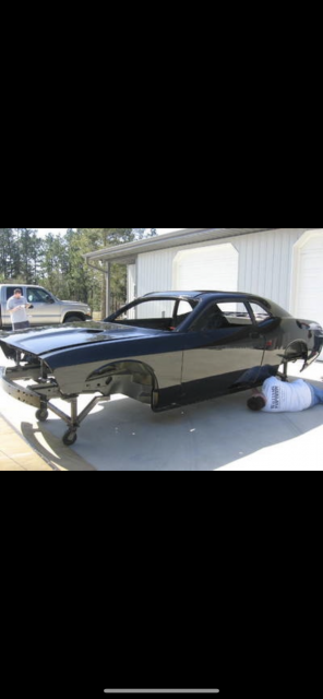

This is how they came from Dodge and they recommended you pick them up in an enclosed trailer. 637BE687-D7D9-4F0F-9E1A-A31EB3F6F8F8.png
Herman shows pictures of the one he owns that they are using for this build. In this case it is a Challenger body without anything attached. No engine/drivetrain. No suspension. No interior/glass/nothing. They do not have a VIN. It is built with the conversion into a race car intended. It’s how the Dragpaks start out.
