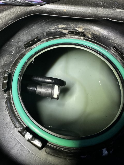

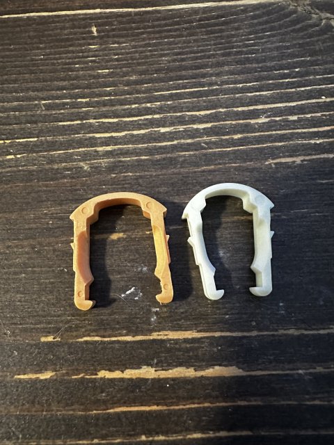

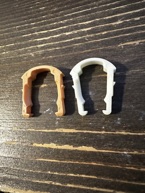

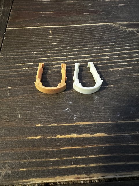

Old on the left, new on the right (white). The old one used to be white. Looks like e85 took all of the tension out of it! Car is fixed 😎 60+ psi at run, and 70+ blipping the throttle. Around 57-60 idling. Drove it around, fired it up/shut it off several times and logged. Calling it good. Hopefully this helps someone else. Thanks again for the suggestion @catdad. Was very lucky only 1 Oreilly had one of them in stock, no other stores
and yes, I got all of the dirt out, tank was all but empty

On the bright side, I can disconnect battery, pull pumps (completely) and drain the tank in 20 minutes or less now πŸ˜…

I got the tool for the fuel pump ring. Still need to use jack handle on breaker bar and it pops. Still less stressful than a sledge and screwdriver

If you’re having fuel pressure issues and run e85, check that clip.

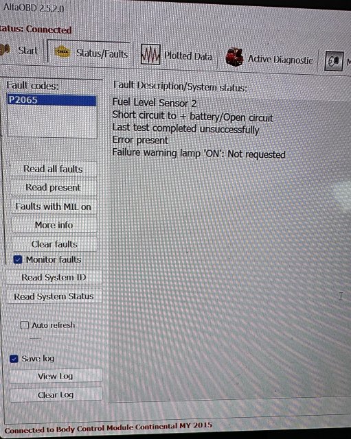

Hmm, so which one is #2? So this doesn’t show a CEL, gas light just flashes and β€œserver fuel sensor” message shows on evic

Tell me I replaced the wrong one πŸ˜‘

Yeah. You did.

If 1 is A and 2 is B...1/A indicates driver and 2/B indicates passenger side according to what I'm reading.

Found it. Discontinued part, but found 1. $70+ shipping. The saga continues

Discontinued? What the piss...
Compare the 2 when it comes in. For science.
Makes no sense to discontinue only one side.

It does when they can force you to buy the entire jet pump for 5-800$ lol. I will and will post a pic. They are 100% different

68145782AA By chance?
