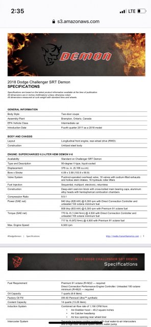

Dodge SRT Demon
Direct Connection performance engine
controller from
the Demon crate says
minimum
100 octane UNLEADED required.
