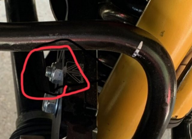

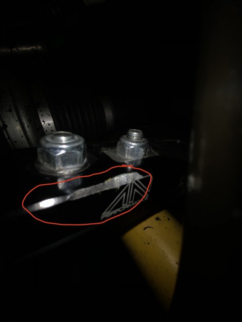

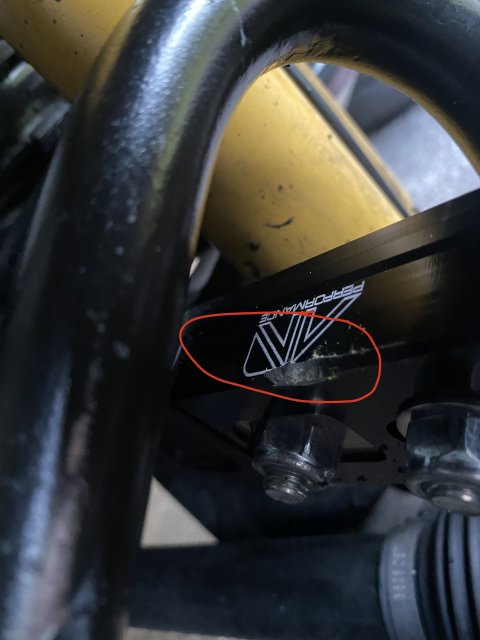

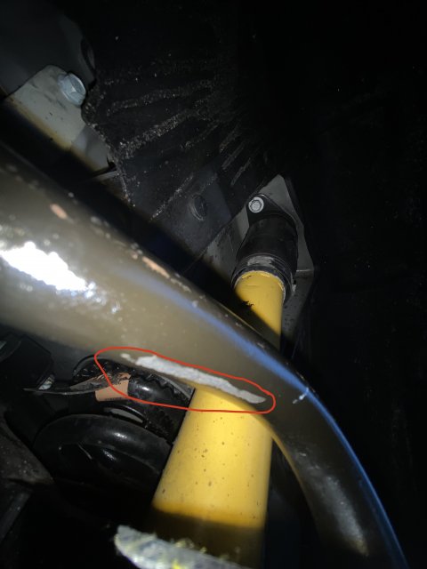

So... @DGatzby discovered that the Razor's edge/StolenLogix billet rear links pull the bar down so far it hits the AAD upper arm on full compression.
Granted it's a condition that most will never see...but still a concern.
I have a bit of the opposite problem in that I need to pull it in with a shorter link for my forgestar.
I'd like to find a happy medium. I plan to do all the rear arms at some point. Possibly this year. I dont want any interference.
He measured a set of either the Razor's Edge or the adjustables that he has on hand and they were 8.25" center to center.
UPR measures 8.375" completely closed on their adjustables.
Does anyone have a measurement for the more common ones like HHP, Bwoody, etc to compare?
I'd like to find something that will clear both.
