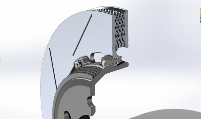

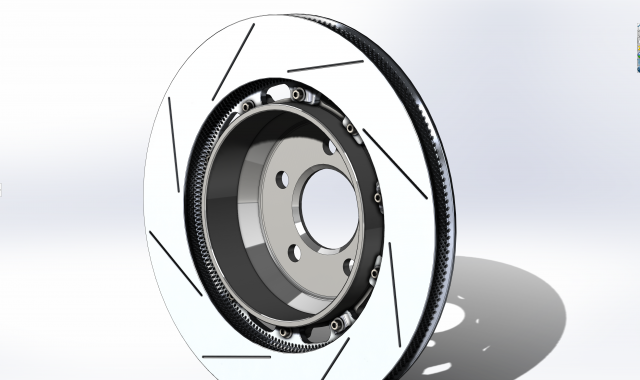

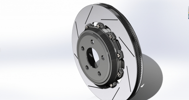

Yours will look better than that.
Floating 2-piece with heat ribs, same rotor design as front but in the 350*28 size. D-bobbins. 10lbs total weight including the heat spreader.
CDT patent pending
