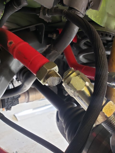

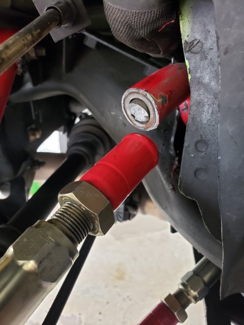

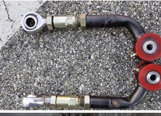

Here’s a pic of the broken arms AD4F0B96-7BFB-4F57-B2C9-EF6AEBA0D681.jpeg BE9B53F9-5EC9-4517-A21D-4D3C9EA0CF43.jpeg 4B666585-D88C-4B68-B68B-6087D76630A9.jpeg

OK, from the above pic it looks like the adjustment rod broke, they must not be a high enough grade to handle the forces thrown at em.

.. I called BMR yesterday and they did say some of there arms are 900 hp and less, and said the on car adjustable upper arms are the ones that brake. i have part numbers for those arms and also the ones they say are for above 900hp.. parts numbers are on my desk and i will post this evening the pics say it all, and the adjuster on that arm is what they said brakes and causes other shit to brake?? Thanks for the pics... that answers all the questions...

So i called BMR back again and talked with Frank he is there mopar guy! ( nice guy). So the arm that hellno posted will be the third arm that has broke in same spot( adjuster) part number ( UTA 112) on car adjustable. UPPER TRAILER ARM... So BMR has rated this arm to 900 hp? i would say that if u make stock power u Should be ok with this arm.. On the street.. But Hp modes u should use a UTA 111 arm that has single adjustment, that would need removed from the car to adjust.. That would be when it is getting alignment! and its cheaper.. SO there is the skinny... if u guys take all ur BMR stuff and scrap it that's on u.. so we know the weak link now.. they also took care of the broken arm from above pics and he also went with UTA111 arm so all is good.. i also Have ordered the single adjustment arms.. And i also asked if they would join the forum..

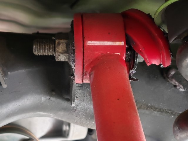

It’s a good to know that it’s that double adjuster that is the weak point and as long as you go with the single.... you’ll be ok because the rest of the arm is really strong. Oh wait! F6E03396-9F57-41B6-B5D5-42FD38805C76.jpeg

It’s a good to know that it’s that double adjuster that is the weak point and as long as you go with the single.... you’ll be ok because the rest of the arm is really strong. Oh wait! View attachment 17090
is this their V1 vsV2. I remember that their arm bent in V1.
I might be below 900 because I’ve been running V2 for 18 months and easily 100+ passes on it. I’ve cut 1.27 60’ , 1.29 60’ and countless 1.3x on it
Or may be they went back to cheaper material like V1 again?
3,534
11,391
#59
Why are they naming their stuff after WW2 Nazi rockets? 😂. I do remember that after they had a issue a while back, they were going to increase the wall thickness on their tubing. I assume they did that (V1vsV2?). Anyway... they make some nice stuff. This whole conversation is just good to provide info for matching the parts you buy to your build. I’m sure Scats and moderately modded Hellcats have nothing to worry about. I have a set of their toe arms that I just took off and will be selling They have never had any issues with those as far as I know.
