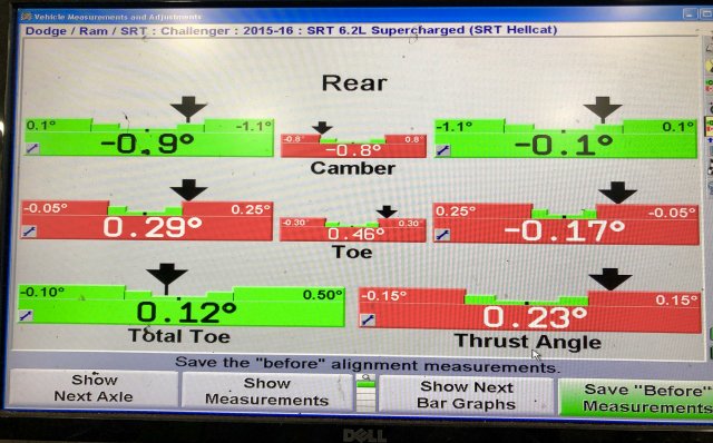

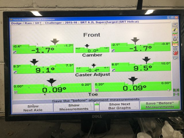

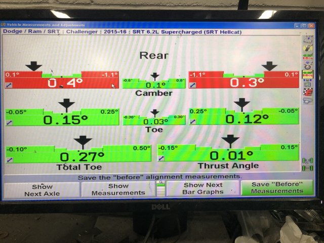

Alright. So I’m out of there. I was there for 5 hrs. he charged me for 3. Yes, 150.00/hr as he advised me from the start. Total 488.00. Below are my before and after rear readings in addition to the front. I haven’t played with it as I had to get right to work. I was looking for as close and flat as he could get it bearing in mind a few of the thoughts you guys suggested here and the other place. Thoughts pls. Thanks.

Front is easy, have him slam the camber and caster tabs, in check it. Anywhere near the specified camber will work. Then simply do the toe, which takes ten minutes in my garage anyway!

I really like the front for the street, your tires will last forever.

That really isn't bad for a first timer and a 5hr crack. The numbers look pretty good overall. I personally would like to keep toe close to 0.10 and if you want to get closer to 0.0 camber go down 1 tab on each side...so if you have 7's go to 6's. Each tab is ~0.20 degrees adjustment or thereabouts...but all that is just being picky. On a good hard launch that should plant plenty flat for you.

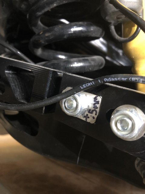

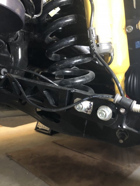

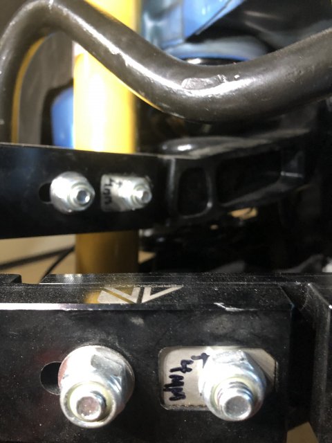

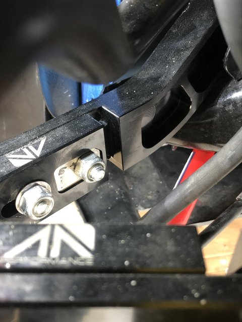

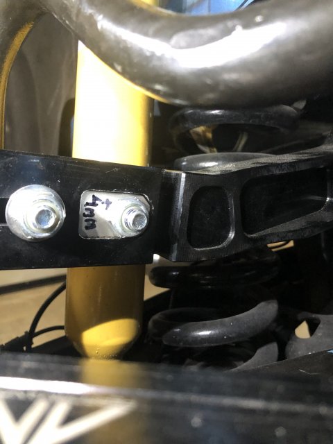

@vortecd under the car today. +4mm on either top arm, and +.5mm on the longest bottom arm. P/s pics first:
B186CB02-8966-4AB6-B3A7-BEA50592D570.jpeg 9C7A6F24-891C-4FB2-A0C1-490DE719FB89.jpeg DDD0B51A-7915-4E79-A618-7B759A1AB887.jpeg A766CEAE-ECA8-4210-8802-C6A84A6183D9.jpeg

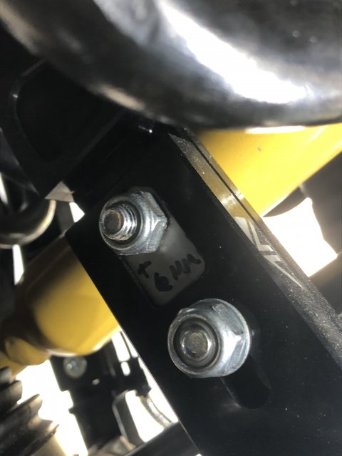

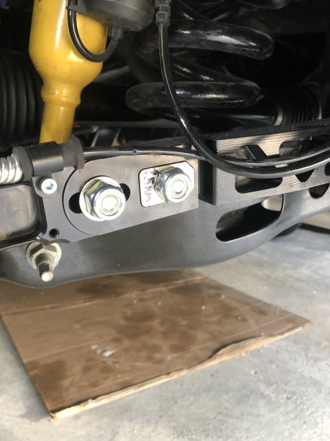

On the d/s both upper arms took +6mm with the longest lower are taking another + .5mm
5F4CEB95-0E86-47A8-A8AE-ED36A4C24577.jpeg C4BD940A-8B37-4531-BCE1-50779B4205C0.jpeg D3988D3E-CBD3-415C-B87A-F1D8B14DC5FD.jpeg D8A177A0-1222-4A15-8A6C-690489AFDC69.jpeg
1,335
1,926
That's less than my car took. I needed 6's and 7's.
Glad to see the toe rods needed minimal tweaking too. They must be pretty close from AAD.
