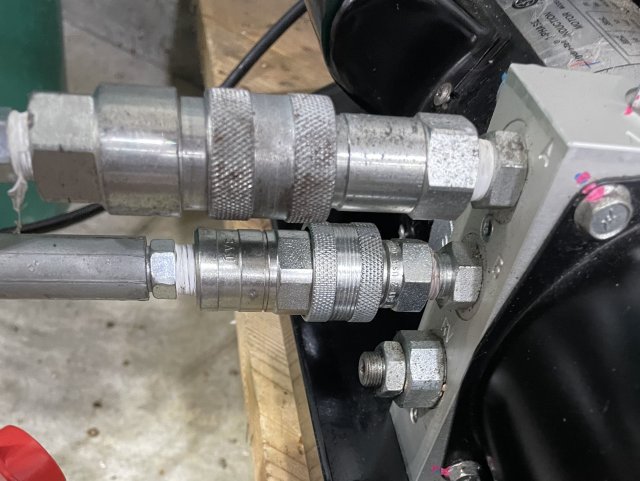

I have had my Quickjack for about two years now and two of the hose fittings (female quick disconnects) and one of the male fittings on the pump has failed as well. When I say failed, I mean they are leaking whenever I pressurize them. Always kept them clean and covered so I’m a little surprised.
Good news is I can get them from a local store. Bad news is they are $40+ each.

Are they typical tractor style quick disconnects?
If so, they do tend to leak. Try a flat face version instead.

They are flat face fittings. I'm on my 2nd QJ (sold my first one to upgrade to the 7000 lb version), and have never had any problems with the hoses or fittings (knock on Chinesium :rolleyes:). I have seen pictures of voids in the hose swelling up like a little balloon - just have to keep an eye on things.

Mine were pissing hydraulic fluid all over the garage floor…

Maybe investigate rebuilding them???
I would think it might just come down to an o-ring???

Yeah mine had that too. I used it and it seems to have worked fine as my fittings are not leaking at the threaded ends, they are leaking at the male/female connections.
When I replaced them I just used Teflon tape.

Probably. I’ve kept the old ones, maybe I’ll ask the hydraulic place I got the fittings from.

Yep, same happened to me. I could not find the exact replacement but close. I may call them sometime to see what they can give us for replacement and how much. That is bullshit I agree.

I went to Northern Tool and get the closest I could. It was about $35. The original units seem larger and more robust, but it still works.

I just got new fittings. I haven’t gotten the new male fitting for the pump yet, didn’t realize that one was failing until today when it leaked fluid all over the floor.
I’m not in your neck of the woods anymore, I live up in Utah now and got it from a local place. But I imagine tractor supply or Granger would have them. If you have time, I’d probably just order them from QJ.
