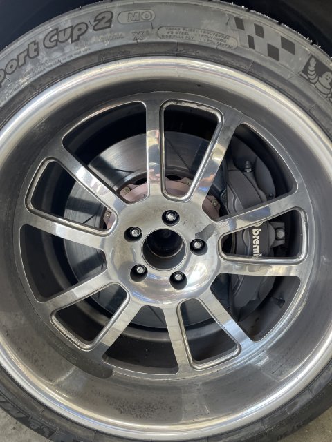

Changed out the pads in 40 min. today. New record. But the four calipers were spotless thanks to the Powerstop pads. So after compacting the pistons a bit the new pads slide right in.
After about 19-20k miles, the Powerstops are about 19/32 thick. I put them on the car at 15 miles.
The new Hawks are 5/8” if your generous. So 0.03” of wear in 20k miles is rather outstanding IMO.
Go bed in the Hawks and the wheels come back looking like this! Yep the DP rotors have checks. They all do it and hope they are my last set. Hint, hint! Dust galore!

These set of pads are working really well on the DP rotors. Nice blue coating on the rotor, exercised them extensively last session. Yes, that is a pile of brake dust at the bottom of the wheel.:cool:
