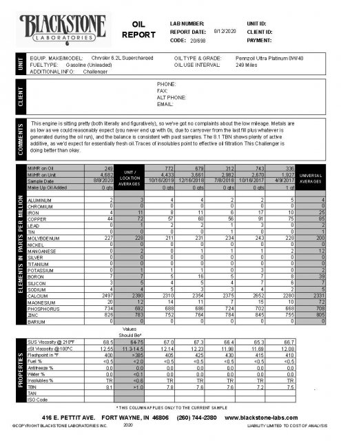

Point of reference:
My latest Blackstone report

Thanks @BULL. Was going to post mine tomorrow for reference. Night.

LOL, Damn Bull put some miles on that oil...In all seriousness I know in your case those miles are some "hard miles" between changes.

It was that stupidly low mileage that made me keep putting off what would have been also "only" a six-month change, but I kept saying to myself, I've only got two miles on the oil, it's fine... Then I finally got two a point where I didn't want to be doing it during the "cold" months, bla bla bla...
