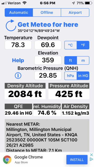

I have an apple phone ,yall know we have a thread for trash talking :ROFLMAO:
I have an auto density app ,it was free to download and I checked it and its accurate with in 5000 DA
