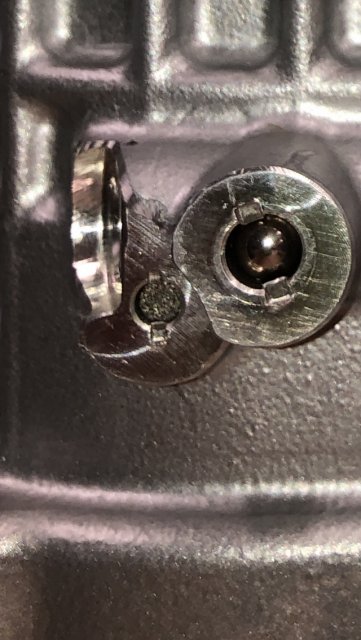

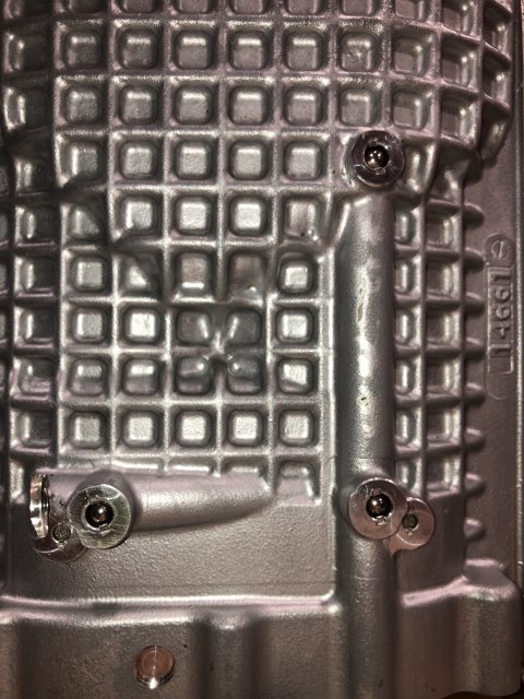

Make sure you don’t block the vent holes on the bottom.
3,687
8,696
Yes, these, their the gear case vents, not the balls the silver porous stone devices next to the seal balls.
We knew about the vents.
We cut a nice hole into the material with a hole punch so that they can breath freely.
7,313
19,175
Well I learned something
