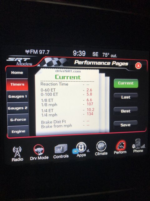

2nd pass after launches with no track 4th time it hooked 633D420B-D3E8-4007-B994-5E7A21A658FB.jpeg

2nd pass after launches with no track 4th time it hooked View attachment 3357
Awesome . Almost 10.2's . It's sucks when the track doesn't prep . That might be fine for civics and skodas but real cars need starting line prep .
I believe it has a 10.2 in it for sure I actually waited a long time and had it hooked the first time the iat was at 120 , I walked up there while I was waiting and asked them if they’re spray it for me but it fell on def ears

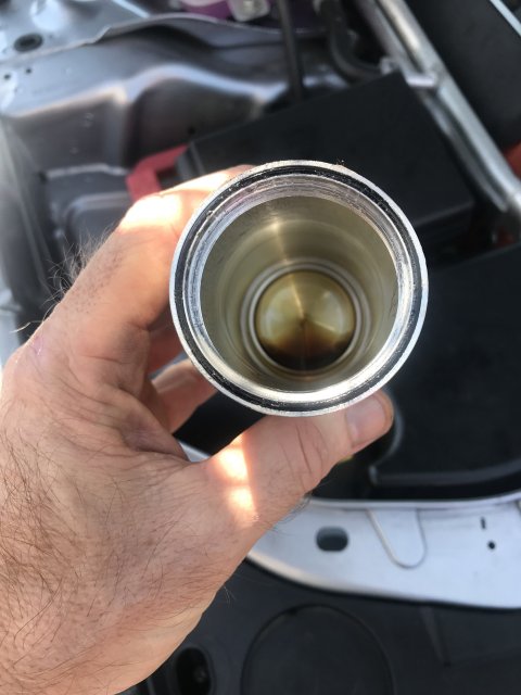

Not much blow by this is my catch can I just removed after running it this week 8EE220C4-34C5-4410-A5F6-E69144159730.jpeg
