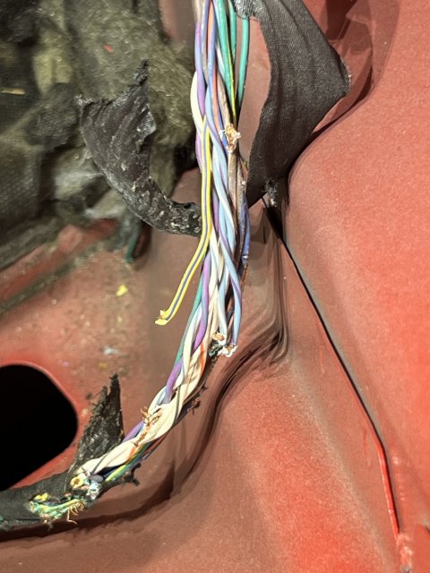

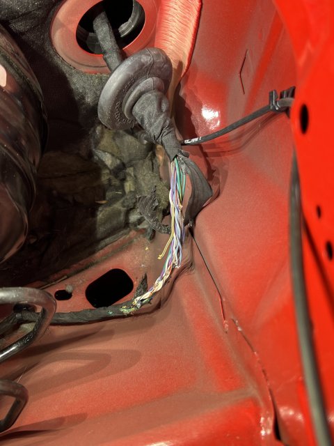

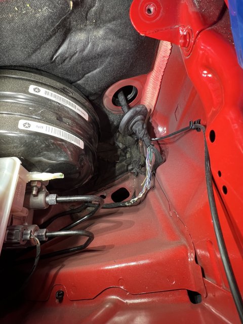

Jim at True Street called and said he took a quick look at it (hes super busy) and sees chewed wires by the brake booster and will let me know what else he finds after he digs into it

That means RATS bro. I bought an RS3 from some Asian dude a few months ago. He lived in Brooklyn. The car had no issues but as soon as I bought it I was having boost issues.
Yep, the freaking RATS ate the rubber boost line and I kept getting an error smfh. He parked his outside in front of his brothers shop behind 6 other cars or something but yep thats most likely ur issue.

I was thinking this was the case. In the garage they started construction and opened up holes. I'm sure they came running out. First time I have had an issue here in 10 yrs of parking here. I wonder what happened to the Lambo Urus that parks next to me. lol
I know its all preliminary but what is next to the brake booster as far as wiring goes?

Thread Starter #59
Ughhhhhh

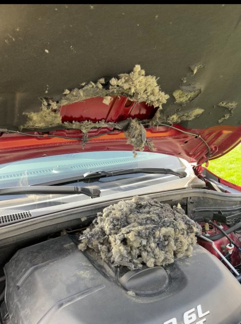

#60
Mice only got to the hood liner of my old Jeep. Keeping rat traps filled with farm grade poison near the vehicle is the only thing that has stopped them.
Bait station
https://a.co/d/byKIlIZ
I used Just One Bite poison, also available on Amazon
