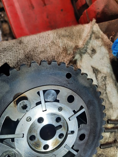

I have the same cam waiting to be used, just installed the vvt block the other day
Ill do that when I get some free time. Otherwise Ill lose it haha.

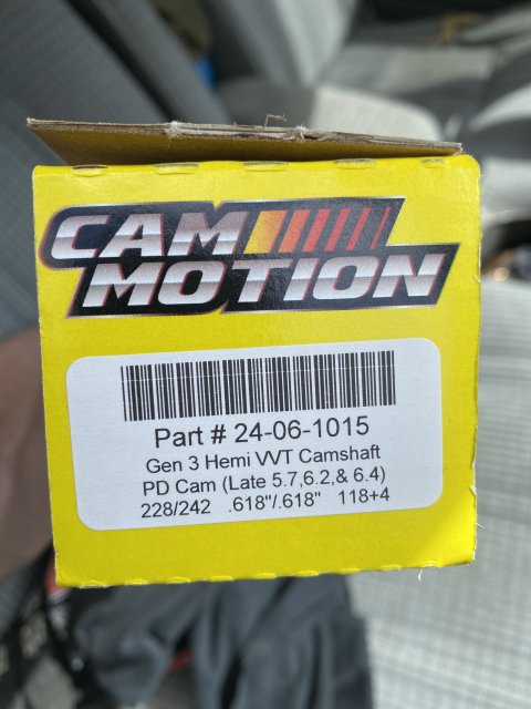

We use both TSP and Cammotion for our cams. I talked with cammotion about my setup, and this is what they recommended. I sort of wished he would have changed it up a little so we could call it our own, but I've been dealing with them for almost 20 years. I trust them, so here we are.
Keep us updated how you like it. I'm hoping it has a little sound, but not too crazy. Want to stay a little incognitoish
@Hpindy has the same cam an you notice a difference from stock but not much.

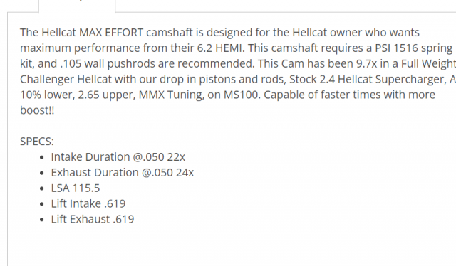

What you guys didn't want this cam that says with a 2.65 upper and a lower you can get a 9.7 1/4 mile :ROFLMAO::ROFLMAO:
I think that would slow you down with those mods.
Thats exactly what I'm looking for. A noticeable idle, but not chopping the forest down
A lot of people go for sound .. that is a function of overlap and valve timing. . That may work on a N/A engine for better scavenging but on a boosted engine you are getting less cylinder trapping on the intake cycle .. you will still need a good exhaust path to get all the spent exhaust out of the cylinder.
Sent from my Armor 8 Pro using Tapatalk
Ouch ....
sure don`t want to go slower:cry:
