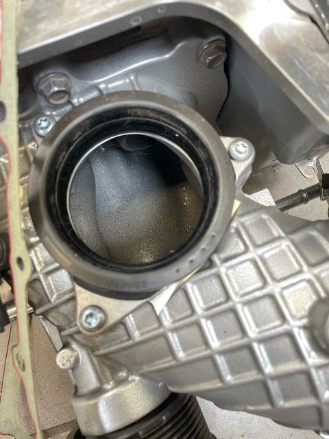

So I have closely, oh very closely inspected a supercharger passage after about 6000 miles of 100% use of the “drivers side” catch can. I confirmed to myself and can pass on two things.
1. Not a drop or hint of oil is in the supercharger intake.
2. That means it was catching anything (and there was some captured) from the left, and either none or an amount not visible must come from the “passenger side”.
Here is a picture. Please ignore the alloy shavings, as they did not originate from the intake direction. This particular supercharger decided to eat itself for brunch last month, and showered its host with a life ending shower of that shit before it seized its’ own fans up after getting a bit too hot too many times.

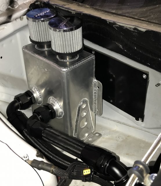

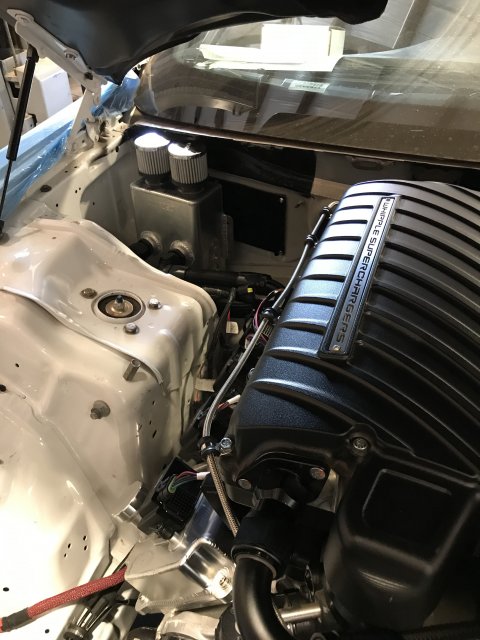

My needs as far as crank case ventilation goes has become a concern due to a couple of new things. The stock Hellcat valve covers have baffling that does a good job of controlling oil. I have always had the common size (small) catch can that was not vented to the outside. It never collected much and I figured it wasn’t really necessary. So now a couple of new things. A different valve train and larger coil packs (Holley EFI) means I needed to go to the fabricated valve covers to make that work. Those things don’t have the internal baffling that the stockers do. I know some people who found out the hard way that these valve covers require a seriously capable catch can 😂. Anyway…. I was originally going to use the Motion Raceworks dual line can that you’re referring to. That is a really nice setup that is versatile in the way that it mounts and I would recommend it that for a high boost motor. I decided instead to go with this Moroso Monster with -16 lines from each side. With all the stuff removed, I have the room to mount it. I would guess a “normal” Hellcat might have a problem with that. A000147A-5B20-4367-AF11-857A0207DE5E.jpeg C0823350-B01E-4445-B8FB-DEF95C2776FF.jpeg

@Marc W, thanks for the reply/explanation, I appreciate it!
