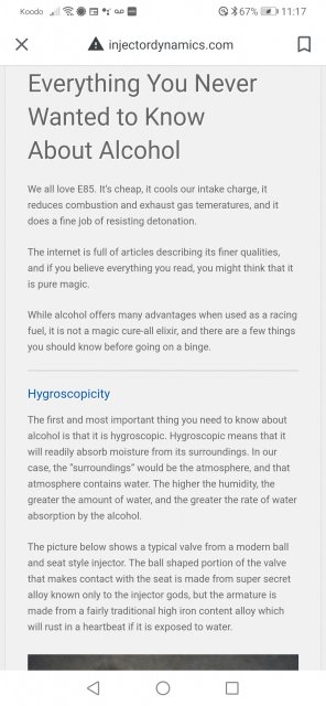

I am not a hater on ethanol. I get the use of ethanol and if I keep the car I will likely go with a flex fuel tune. Even though we don't have pump E85 here. At least it is a little cheaper than race gas.
There are lots of articles on the pros and cons of ethanol fuels.

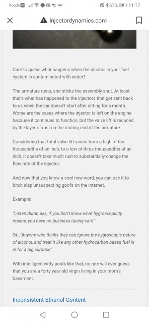

Catdodgehell from the other forum had posted quite a bit of info there. I just did a quick look and this is interesting but from Injector Dynamics. Screenshot_20210527_111728_com.google.android.googlequicksearchbox.jpg Screenshot_20210527_111736_com.google.android.googlequicksearchbox.jpg

Lol didn't intend for this to become an ethanol debate. Just be sure to use the right parts.
LOL. Sorry about that.
At least it isn't a f'ing political thread.
Info is good though.
I am sure that some are not aware if issues with Ethanol especially when it is exposed to atmosphere/ moisture.
Most look only at the gains.
One of the articles I was looking for mentions thst E85 stored in a plastic gas can may be bad in as little as 30 days.

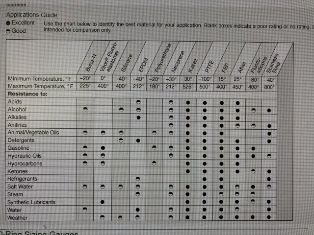

Silicon is so-so, Kalrez last forever, Buna doesn’t take the heat for long and gets hard and leaks

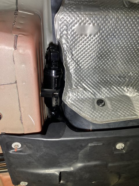

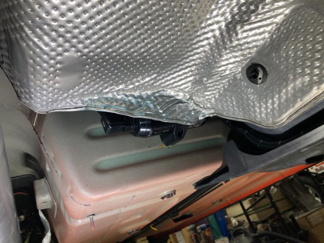

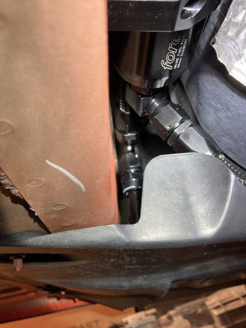

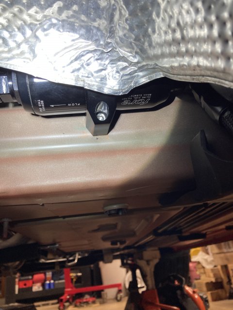

There are flexible lines but none are rubber, their that hard flexible black plastic stuff with quick couplings ends each end that couple to a stainless fuel line that runs from just under the fuel tank to about 12” from the fuel rail connector. I added the Tapped Performance E85 Fore Systems Microglass element 88mm filter unit which adds about 2ft of that special braided hose that fuel does not permeate through.
5CD57962-2491-4DB2-923E-22357A949D13.jpeg 080F8134-CA4E-447B-9068-7111C3C6E7F4.jpeg 03FA6FAC-FBCD-4E27-8211-57B4F9E09E60.jpeg FB80981A-8BDA-42DD-AED0-138D1C9C35D2.jpeg

Nice clean install. How'd you get to the top self tapper on the mounting bracket for the filter?

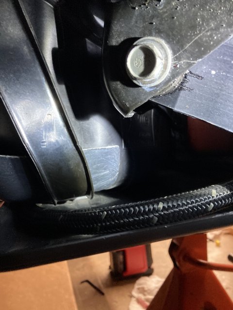

I didn’t use the included self tapping rust makers LOL. I used 6mm SS blind rivets and put RTV on them before setting them then painted over them. I used a dremel with a right angle head and a end cutting burr to make the holes in the body. Then fastened the mount with 2 6mm SS hex head cap screws into the threaded blind rivets. I don’t like sloppy LOL. Here you can see one, there’s no seeing the other once the heat shield was put back on. image.jpg

You're the man. Can work on my junk anytime.
