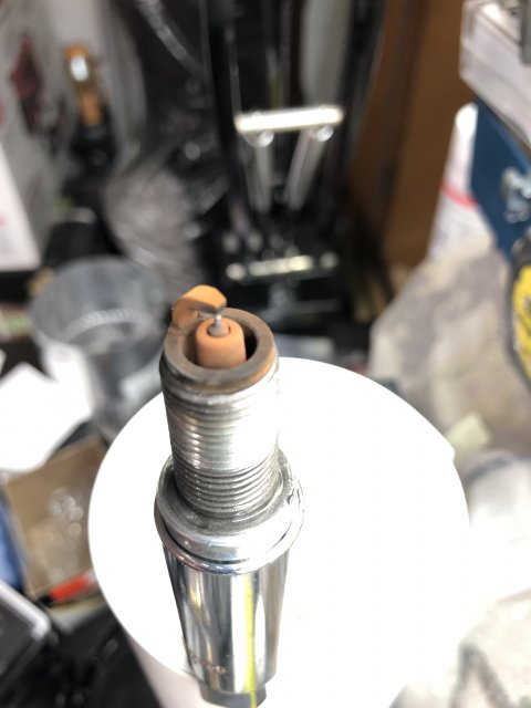

They run nice at 16 psi boost on pump 93 These were run with Torco, Boostane doesn’t make them as orange but burn as clean. ECA44438-C206-4C60-BCF4-FCC8A3116663.jpeg

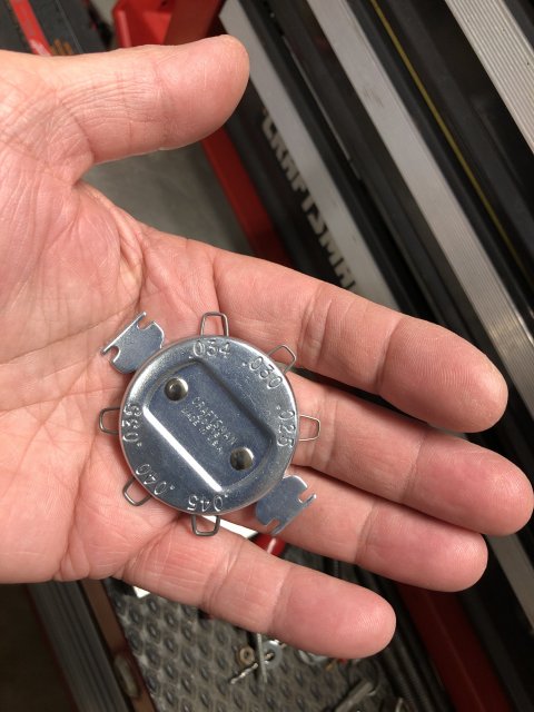

I use this Craftsman one, #40816
3,635
8,549
I use 2 together, one to hold and one to make the tweak with
