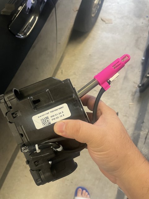

shifter was put in, code didnt go away, car goes into limp
i have a hp90 tcm but getting on mikes schedule has been hard, everyone is getting ready for MIR and the mhsh so they have been taking up his time, sadly my car is not a priority

So after we dropped the pan to install the new TCM we found a part missing from the install. I was on the phone with Pure till about 10pm last night, calm and collected telling them how I wanted this resolved. Once the dust settles I will do a full disclosure. Safe to say my 2022 season is over. Very disappointed in the shop that has the Mopar and DSR contracts. To be fair there are a ton of cars running their transmissions. A lot I have reached out to on IG to see if they have the same issues, none, drop in and drive. I seem to just have a case of bad luck.
