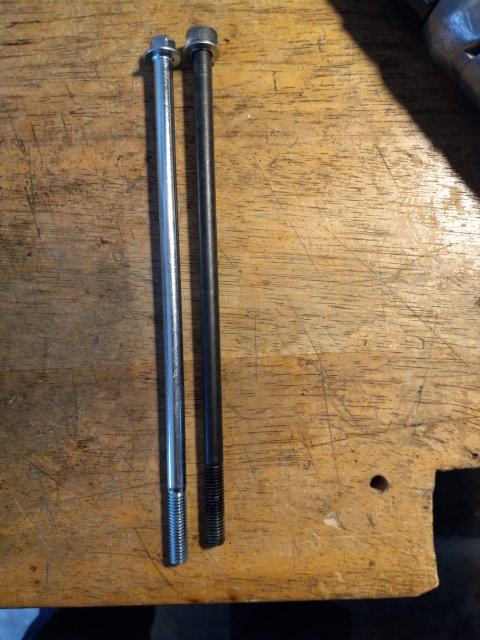

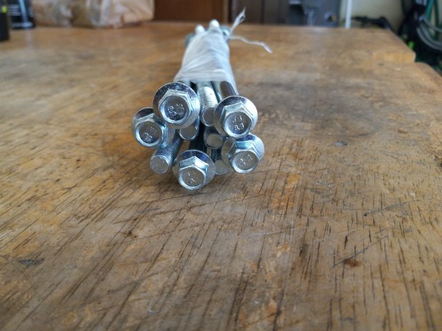

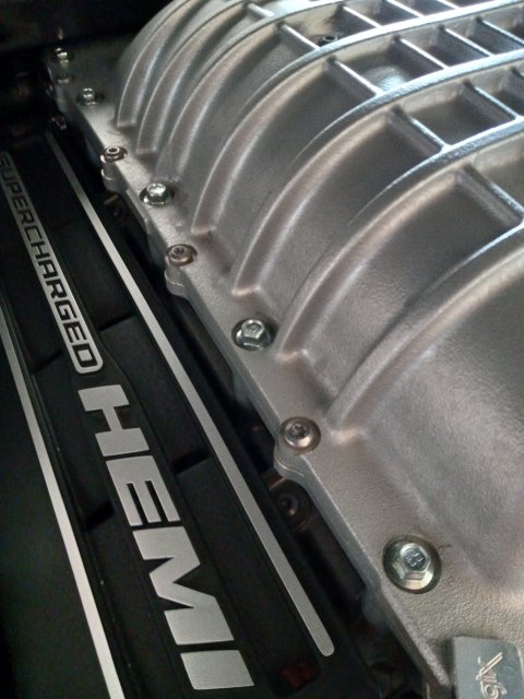

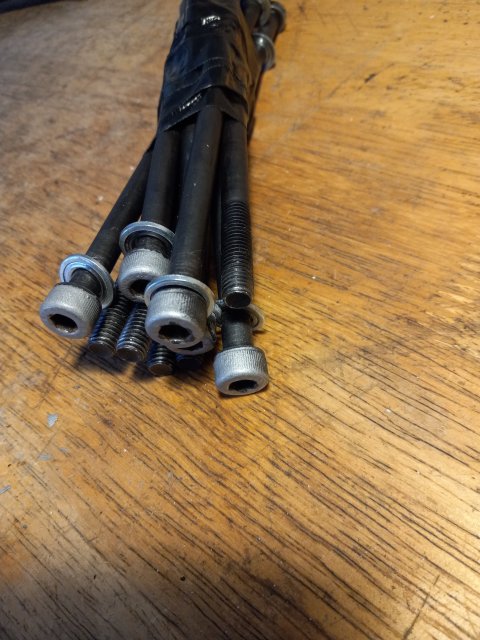

FYI - I bought (I'm not selling them) these new bolts from the old forum, these are 10mm longer than the factory bolts to go with the 10mm FI Spacers. The bolts that come with the spacers are only 5mm longer than factory so really too short.
These new ones also have flanged head for 10mm socket, like factory & zinc plated so they don't rust & their 8.8 grade bolts.
These look & function 100% better than the bolts with the original FI 10mm Spacer kits.
