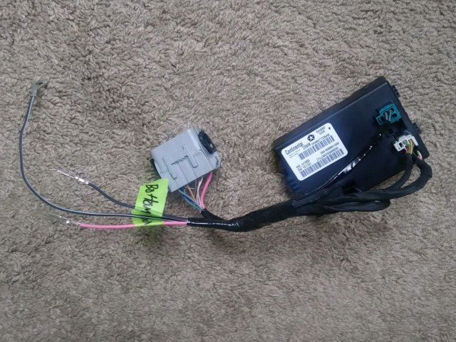

I assumed only the passenger airbag was disabled ,but thinking about it the drivers heated seat won’t work with the passenger seat removed so maybe when the pass seat is unplugged multiple circuits are broken including all airbags.Thats not good 🤔
In no case are any of the restraint/airbag system circuts wired in series.
The Drivers seat heat and cooling no longer work when removing the Pass seat, is due to the MODULE for those features being located underneath the Pass seat. So it goes byby when you remove the Pass seat. I actually make a work around for that issue (See pic). VENT ENABLE WO CONNECTOR.jpg
The Drivers seat heat and cooling no longer work when removing the Pass seat, is due to the MODULE for those features being located underneath the Pass seat. So it goes byby when you remove the Pass seat. I actually make a work around for that issue (See pic). View attachment 59444
