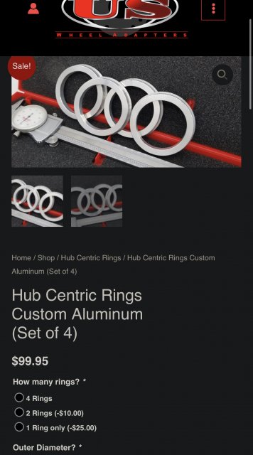

I used US wheel adapters. They had the forgestar wheels in their system already so knew the size, found the email.

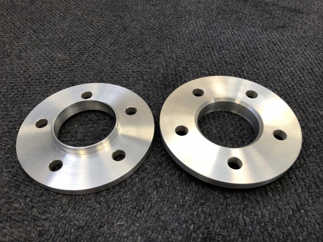

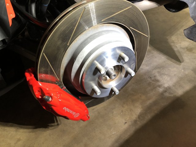

Here’s the ones I made, they locate the rim same as stock does. These are custom diameter hub centric pilot for Race Star rims. I made a few sets in different widths, 10, 14, 18mm, work great.
View attachment 135944 View attachment 135945
I had stock bore hub centric spacers made (with the lip) and then got the rings made for the inside of my forgestar wheels. This way I can use the spacers with my stock wheels still
