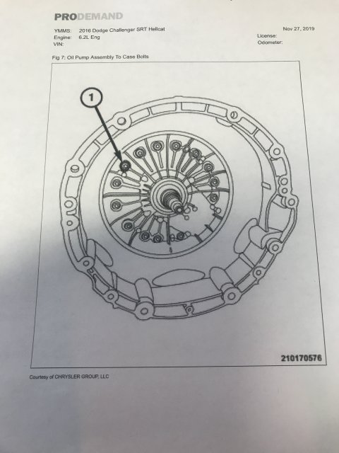

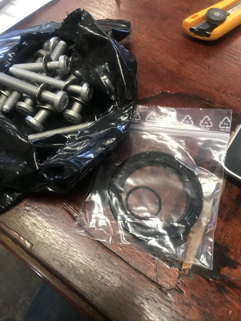

HERES THE PUMP BOLT KIT I SPOKE ABOUT THAT YOU WILL NEED IF EVER REMOVING THE PUMP BECAUSE THEY ONE TIME USE ,THERE IS ALSO A PROPER TORQUE PROCEDURE WHEN INSTALLING THEM ,
IN ORDER TO SEAT THE OIL PUMP ASSY PROPERLU TIGHTEN BOLTS 1,7 AND 9 TO6 N.M ( 53 INCH LBS) ,THEN WORKING CLOCKWISE PATTERN BEGINNING WITH NUMBER 1 TIGHTEN TO10 N.M( 89 INCH LBS ) THEN WORKING IN A CLOCK WISE PATTERN TIGHTEN AN ADDITIONAL 90 DEGREES
As you can see the bolt kit comes with new from seal and input shaft oring image.jpg 3399EE25-7961-42B1-9422-FBAA2377A468.jpeg

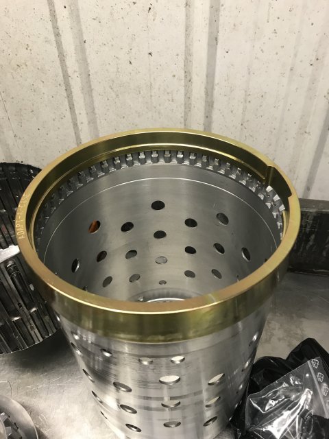

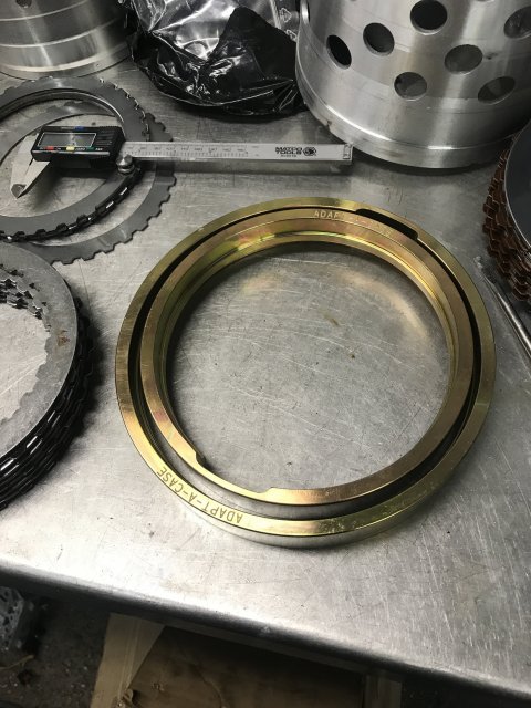

In case you tackle one of these transmissions yourself you will need theses adapt a case sleeves to remove the c d and e clutches from the aluminum shells without them you will break the shells don’t kid your self thinking you can do it with out them
Also you remove the rings a 180 degrees from the ring opening 8E502785-0599-48E3-AD3C-C4CD243C79C6.jpeg F53BA568-A60D-44B8-B9AB-BFAFF1352537.jpeg
