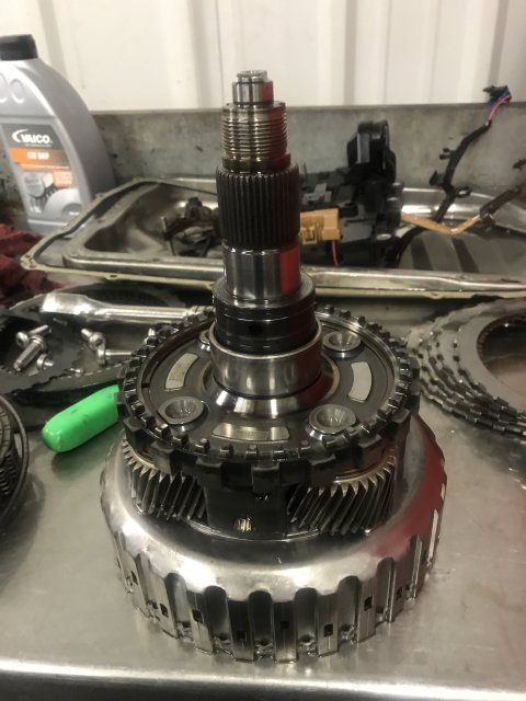

APARENTYLY THESE TRANSMISSIONS HAVE FAILED MORE OFTEN THEN WE HINK BECAUSE SINCE I STARTED ON MINE I HAVE FOUND SEVERAL WHO ARE ON 2ND OR 3RD THRANSMISSIONS IN THEIR CARS AND IT SEEMS TO BE THE HIGH HORSPOWER ONES ,ID LIKE TO KNOW IF ANYONE HERE HAS EXPERIENCE THE BREAKAGE OF THE OUTPUT SHAFT AND IF SO DID IT REAK ON THE LAUNCH OR ON THE SHIFT ?? IVE HEARD ABOUT THIS HAPPENING

Here’s a pic of the output shaft , imagine people are breaking these , what I want to know is did it break on the launch or on the shift AD9CF93E-4327-44BD-8A1F-417F2B165D6C.jpeg
Here’s a pic of the output shaft , imagine people are breaking these , what I want to know is did it break on the launch or on the shift View attachment 7866
Where is it breaking? What part of te shaft ?

I HAVENT SEEN IT I ONLY HEARD FROM CURT THAT THEY HAVE BROKEN IF YOU SEE WHERE IT BREAKS YOU COULD POSSIBLY ADDRESS THE WEAKNESS BUT OF COURSE TURNING THE PRESSURE UP BREAKS PARTS AS WELL

TO REPLICATE THAT P4 PLANATARY WITH A STRONGER ONE I WOULD THINK THE COST WOULD BE A BIG FACTOR IT ISNT JUST THE OUT PUT SHAFT LIKE A GM OR FORD

I WOULDNT BE SURPRIZED THAT WHEN THEY DO BREAK ITS ON THE SHIFT
