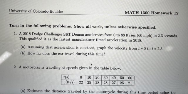

My son is taking Calculus I at the University of Colorado and sent me this in a text tonight...
PS show your work if you plan to answer! :LOL:

Well my brain is very old, but these problems were fun back in the day. I’ll try. I am sure the professor wants to see the students show some derivatives in this fundamental calculus problem. We will skip that for the benefit of our Forum members.
I remember my first Calculus final, where it hit me. The calculus was just one little step in what usually is just a big algebra problem. But given the derived equation delta x or the distance traveled (distance) = initial velocity x time + (.5)x acceleration x time squared. I get 101.2’ in 2.3 seconds. For the answer to #2.
Simple multiplication can be used after utilizing another given and derived calculus equation that the acceleration is 38.26 ft per second per second or 38’ per second squared.
To graph it, the initial velocity is zero, 38.26 ft/sec after one second, 76.52 ft/sec after two seconds and then we arrive at about the 88 ft/sec velocity after 2.3 seconds.
If that is not close, then WTF I’ll just continue to use rulers, speedometers and my IPhone apps!

88 ft/s velocity at the end.
So zero acceleration (ft/s^2) to 88 ft/s^2 with llinear/constant accel to 2.3s
So, 44 avg accel (0+88/2) x 2.3 seconds.
Distance traveled = 101.2 ft
Given 60 ft times in the 1.4-1.5 range this all makes reasonable sense (which is always nice lol)

Okay average acceleration is (88fps/2.3 seconds)/= a, which is 38.26 fps^2, or 1.1897036556348691325978801643954g
d= 1/2*(a*2.3^2)=101.2 feet.
101.2 feet to do 60mph is pretty good. You can't even fall that fast.
