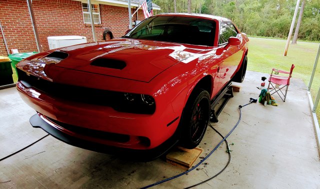

As I have Mopar springs, and got the extension adapter (so jack actually contacts front and rear lift points), I made wooden jack stands to drive up on. 0905211325.jpg

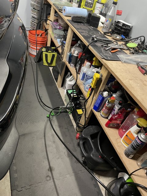

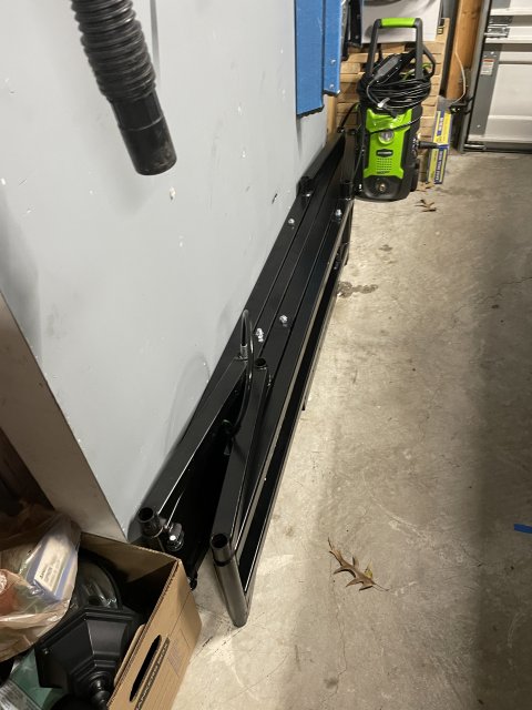

Permanent location of pump and cable route. Also figure out radial shift and storage.
