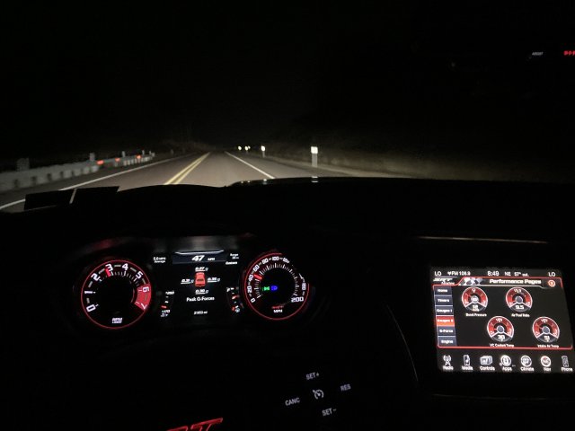

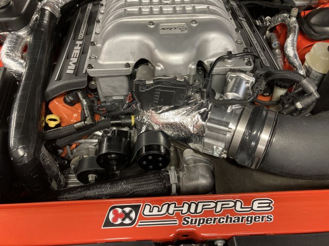

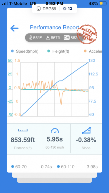

I was out last night for a joy ride
3D11ED3B-5139-41C1-A9E4-98FE06CA5616.png 42464F3A-7BC3-42F2-AC82-A41142E84107.jpeg 4A6DFD2B-8AED-4AE3-8119-EC035FF32D67.png
Will there be a difference when it comes back?
The ported heads I think picked up a solid .1 to .2 seconds in my 60 to 130 time with the 2.4 blower. The acceleration difference between the two for now and the Whipple it’s about point1 seconds every 10 miles an hour the 24 picks up about .7 to .72 seconds for every 10 mph the Whipple was doing about . 6 to .62 every 10 mph which is a solid half a second in the 60 to 130. seeing that there is revision K out now I think I need to get my Whipple back on and beat on it a little bit and see how it does and use up some of its time and it’s still warranty. So maybe it ends up going back one more time before its one-year warranty is out to be upgraded to the latest version or maybe it might even hold but only running it will tell.

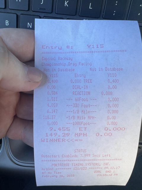

Had another good day of testing this super soft no prep tune for next weekend. all very soft launches no spinning and went A-B. done on an E70 tune shifting at 6300 with timing pulled on all shifts to not shock the tires.

You running 315s? I see that most of the cars are transferring weight like the old school cars did.

Until next weekend I'm on 29.5x10.5x15 MT pro bracket radials. After that I will be switching to the 315/60/15 radial Pro's
