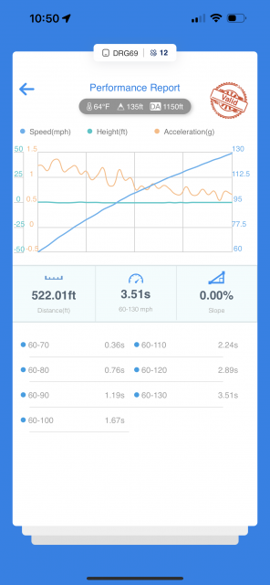

Making some progress here too. hope to get into the high 2's before the season is over. hopefully with some better DA

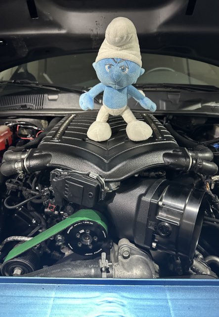

Is that a nick Williams throttle body on the whipple?

hahaha we will see if any more is needed with this monster.
Hatermkr
#15491
1,279
2,652
West bend
WI
2016 helldemon
How do you fit a 130mm on a 3.0???? Maybe you have a 3.8 that’s the only one a 3.8 bolts to with no adapter.
3,639
11,743
That is a 3.8. You can see where the snout steps out at the TB.
Just upgraded to the 3.8 this week.

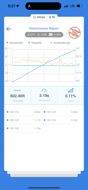

Have u tried that 60-130 on the street? Interested in what it does there.
I don’t do any street racing. Last time I tried was something terrible like mid 4’s with all kinds of power pulled out and spinning. I attempted a 100-150 on the street with some power but kept spinning. I think best on the street for that was like 3.75.
