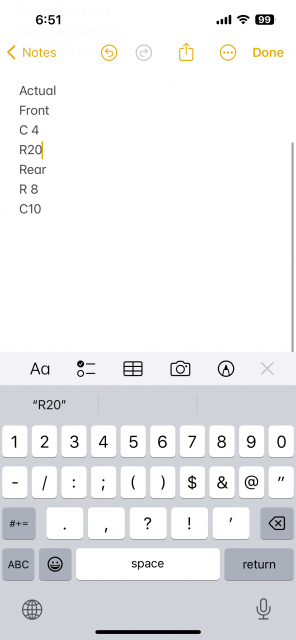

Here is where I landed on some pretty bad prep this weekend if you are still looking for some advise. This was my first time out with them I still have a lot to learn. But this got me down the track when others were struggling. I have a lot more settings to try.
4,364
10,844
Next run I'm going to try this at an open test n tune. I think this is a good next test for me and will get me pretty dang close to where I will leave it for most events.
Fronts
C 4
R 18
Rears
C10
R12
