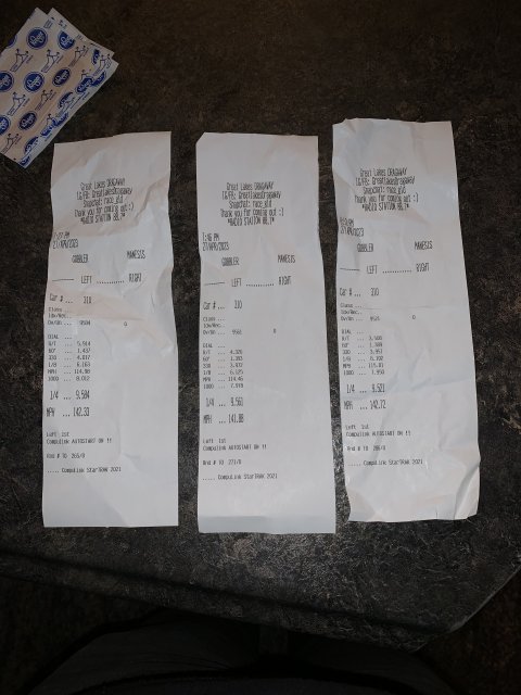

To keep it short
-Built A8 Trans
-Gen 5 stage 2 3.0 Whipple
-Menscer's all the way around with a full AAD control arm set in the rear
-15inch Conversion
Car made 970whp (Still on a stock motor 🙃)
Best ET was a 9.5 @142 with a 1.38 60' on my old setup, haven't run the car on the new setup yet.

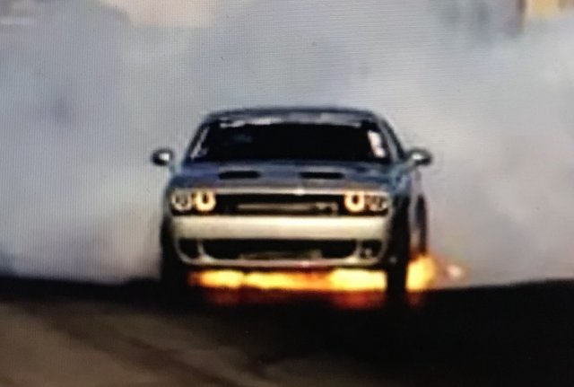

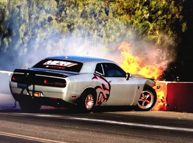

The problem with making big power on a stock block is…. it’s fine until it isn’t. One of the most likely failures to happen is a rod failure. That can look like this…… IMG_3576.jpeg IMG_3579.jpeg

The problem with making big power on a stock block is…. it’s fine until it isn’t. One of the most likely failures to happen is a rod failure. That can look like this…… View attachment 144553 View attachment 144554
Wow I forgot about these pictures. Talk about a bad dream.
