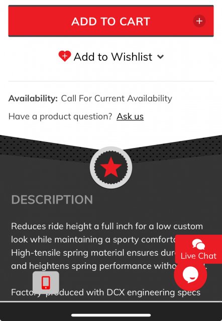

They may be the correct units, but I do not think he has any….
9,028
54,710
I got someone on it. If Mopar has any he will sell them to me. Or he will tell me what to buy. I’ll report back.
