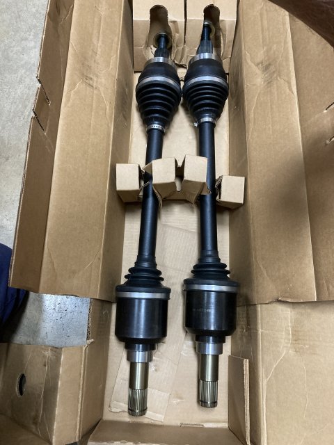

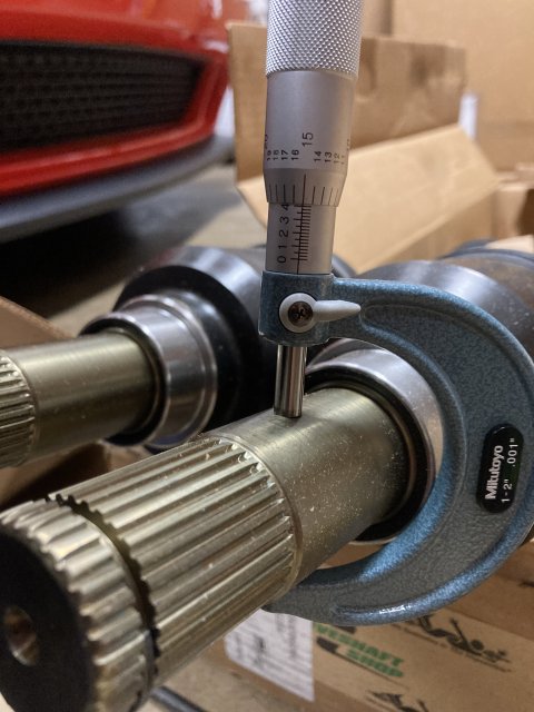

Be sure and measure the Diff side stubs to make sure they are at least 1.414” min 1.416” best or they will wobble and shake in the Diff.

Why would you have to measure a brand new product that’s supposed to be machined perfectly. Getting tired of these aftermarket axle companies
Yeah … that … just put the last nail in the coffin. 2200 bucks for something that cant be made to .000 specs is absolutely absurd.
Agree, but until “somebody” started checking parts because the got a set that’s wobbled in their Diff and pointed such out to them why they didn’t know they had a problem. They now do some QC checking of incoming parts from their suppliers, they should be doing more, most ALL of them. This Not just DSS axles but GForce too. There also was issues with material hardness differences from stub to stub which now they are checking such as well.
Many top name suppers having quality issues from parts not made in house, Comp Cams for instance, hardening issues with their cam shafts. Personally I’d use Cam Dynamics over Comp atm. Whipple, their name is becoming mud because of crappy out sourced parts and then mistakes of under-skilled or under caring workers putting the stuff together poorly or altogether wrong or disgruntled workers doing things wrong on purpose. I pity those buying new cats or anything in general, I think they’re going to be in for unpleasant experiences.
