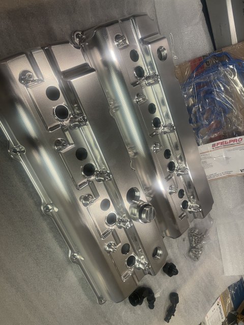

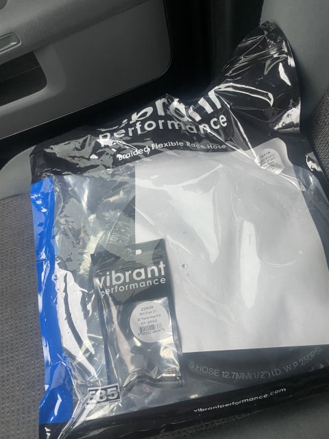

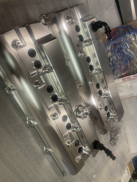

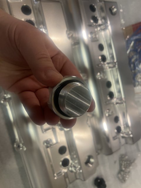

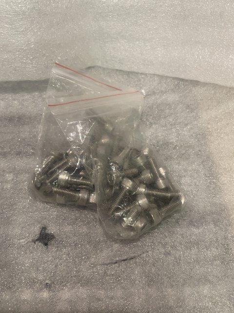

I love it when a plan comes together. These just arrived.
1C74ED6B-8FBC-4A70-8322-B96AB8E5FB7A.jpeg E25716DB-567F-48F3-AA79-A867AC7E4434.jpeg C8F4D822-261C-47F6-A09E-1593DCE8E4B1.jpeg 61B43E77-8298-46F3-A296-F2A3AA44267C.jpeg 28AA20D0-465C-4282-BBCD-5952230A7998.jpeg

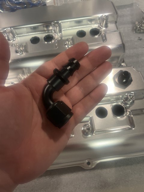

purchased separately from Vibrant
12 orb to -8 an for the vents. The current JLT cans use 1/2” line. So I picked up a few -8 an fittings and hose. Helps a vibrant warehouse is two miles away and the guys like your hellcat.
i need some motivation to get this done :)
7,494
19,690
How do they help with plug changes?
4,117
10,340
Thread Starter #1,120
all the space… No goofy ass un-needed baffles.
