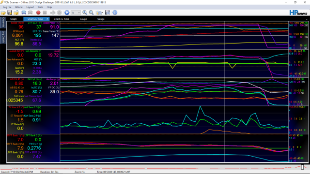

I haven’t looked at the logs but idling at 50 injector percent duty cycle is not normal at all
4,134
10,408
Thread Starter #902
Thats pump duty cycle my bad, not inj duty cycle.
7,609
19,941
My fuel pump DC is 45-47% on E85 at idle so I'd say that's fine. At WOT mine's around 80-82% in good air.
4,134
10,408
Thread Starter #904
My next check will be Friday at MIR, I'll let yall know how it goes.

You're actually not dropping that much fuel pressure but you also don't have a lot of injector head room to cover for it. Even if it maintains 80+ psi, you'd probably run out of injector in negative DA as it stands.
With that said, I would add a single bap plugged into the slave fpdm. That'll fix your fuel pressure issue for the time being. You might have to add a 2nd one when the air gets cold if you stick to this configuration. You can also target higher fuel pressure during WOT operation but that'll just cause the fuel pressure to drop faster once pump flow is mechanically maxed out.
Your bypass valve is also on the verge of triggering a limp mode condition. This is typical whenever pushing over 21 psi of boost. As you mentioned, it is just an srt4 throttle body after all, not really designed for this use case. There are companies out there that sell modified bypass valves with a stronger motor. Either lower boost or upgrade your bypass if you want to avoid future frustrations. You could also take a chance that another bypass might be a little stronger but it could also be weaker. I don't recommend that route for you given where you're at with this car.
Your 1-2 2-3 short shift issue, that's weird. It's not skipping 2nd gear though, it can't physically do that, but it's triggering the 2-3 shift right after completing the 1-2. As to why, I couldn't tell ya. It's not something I've seen before which would be kind of odd don't you think?

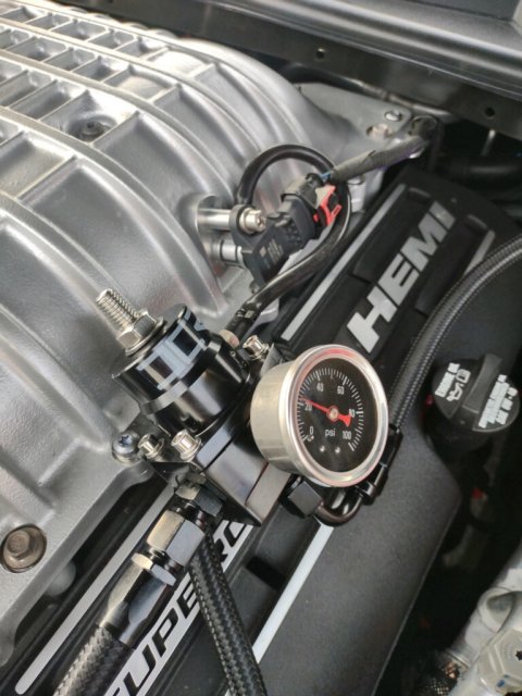

Well good news, I'm done racing for the season... bad news... I'm out of fuel pump based on some feedback in this thread. The injectors spike as the pump reaches max duty cycle then the inejctors spike and as a result fuel pressure drops. The only thing I could do is put a BAP on the non monitored FPWM but I've not had a great experience with those. I could also upgrade to a triple pump setup but I don't know if that is even possible on our returnless systems. Another birdy in my ear mentioned changing to a return style system could solve a lot of this. Thoughts?
I know @jonx96 runs duals with a bap I believe, but I am hesitant to go that route again. Having a car almost blow up cause of them will do that to you. I'm just angry at myself, if I knew all this was going to happen I would have stayed on a 2.72 hellraiser and just sold the car then. :(
For all those that ever read this post. Leave your car stock, you'll be a lot happier in the end. If you want a racecar build a racecar. Also tidbit, the 285 is actually a 470lph pump and the 295 is the true 525... bullshit ass marketing wank.
