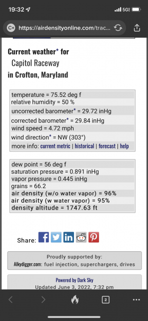

The air is not that good, saw 21-22 at max. I've definitely exceeded the airflow model. Car turned off on a hell of a rip. Coasted to 9.7 @ 138 with a 1.3x 60', she was scooching. So fugging pissed.

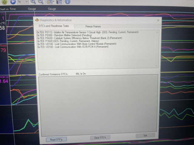

Hmm maybe missed a table. I’ll post a few tables later for you to check.
I think I sent you the engine diagnostics ones but did I send you the ones in the engine tune?

Your issue is mechanical, not tune related. Swap out the bypass valve with a fresh one and hope it performs better.
