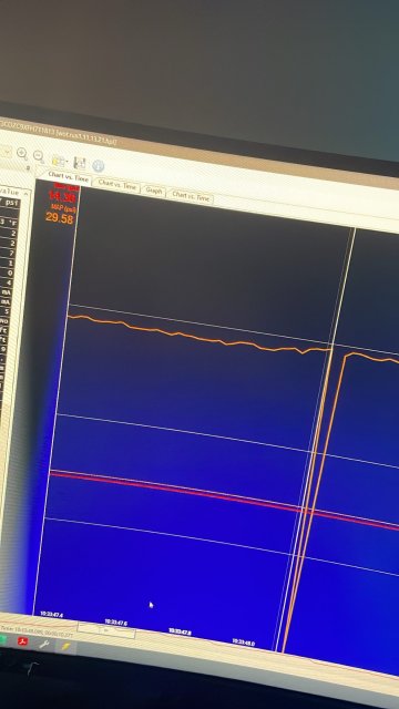

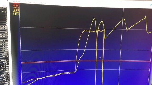

In other news I was checking all logs to make sure it was safe to start Speed Density tuning and I found that I was exceeding the stock oem Hellcat map sensor. The sensor would hang in till about third gear and yeet.
49F86E38-154F-49C5-8FD5-6E5ED2F9C0D1.jpeg 5EA8DAD6-42F9-4713-9374-83E9D609B378.jpeg
So my switch to SD is delayed till I replace all the necessary sensors. Could explain why ANN would just wig out and give me the red lightning bolts of doom.

Will the RE / Demons sensors work ?

Will the RE or Demons sensors work ?
I am sourcing four demon sensors. I will have look at the scale on the Demon tunes and place that in my tune.

Redeye or Demon sensors ...both are the same.
