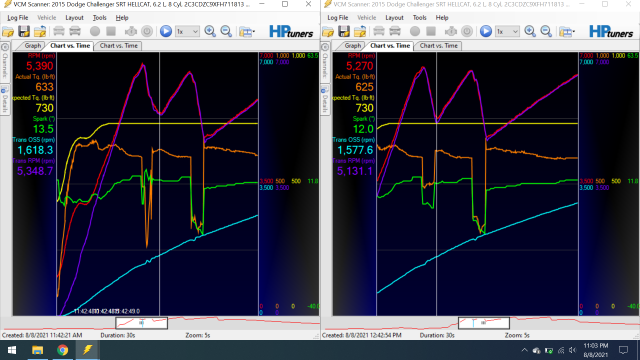

Empirically the 60' was better, da was lower and temperature as well. I also have another theory, I've been taking the Tuning School ZF course and I have a theory on the TCM as it gets hotter, the torque holes (period of oncoming clutch vs offgoing clutch -> this is the rpm drop till the next clutch engages) was longer. Here is a side by side comparison, run 1 on left, run 2 on right.
The 1-2 shift had a quick recovery time and that could have helped a lot saw, 13.5* of spark on the recovery as opposed to 12.0 on the second run. Which means the spark modifier tables came into play for temperature. The ZF transmission is a fickle beast but I'm wrapping my head around it, even more so than the stupid 6.2 HEMI with tables upon tables and models upon models. The ZF tuning theory is simple: decrease "torque hole" width and you can shave measurable time off. Maybe one day I'll tune my trans... Till then I leave it to my tuning wizard.

I'm no tuner or can read data logs but it makes sense to me from what you said about torque holes at the shift points & trans being too hot.
I've noticed that when I end up having to idle too long (with chiller) waiting to make a pass, my ET's aren't as good. I think the trans is too hot when that happens. That's what happen on my 10.20 pass, idled too long b4 pass. I was expecting to do better than the 10.17 or the 10.18 but it went a little slower.

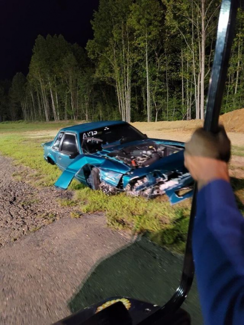

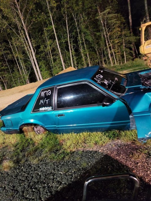

Video of the crash from last night. I was in the lanes right behind the guys. It was nutty. Having a cage was on my mind if I ever went 9s, now it will be mandatory after watching the carnage from last night.
Pics from a friend.

Was the guy ok ?...What happen ?....did it blow & got in his own oil ?... doesn't surprise me that it's a mustang.
His wheels were up I think for the length of the run and when it came down, veered to the right.
Oooops,,,, dead stang. Legs up. 5.0 gone.

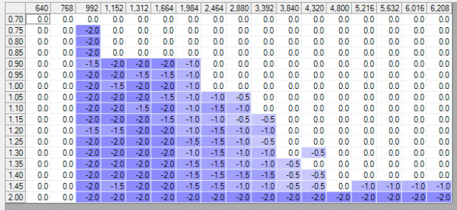

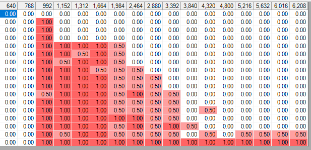

Well more importantly hope the puppers is okay, seems like a very cute snuggle buddy compared to my 120lb bed hog. I can review all the footage as it is a 360 camera and see if any black puffs come out in the runs (technology is fun). These runs are from Friday night when the timing was wonky, I think you have seen logs one and two, I am attaching all of them in this thread to keep things sort of neat. Only shit on the other thread cause I was frustrated to hell at the track and Wi-Fi was spotty.

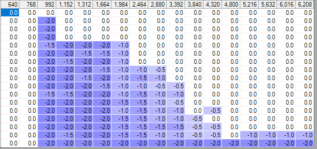

So in the tune from runs 1 & 2 the spark table was modified and timing was added, in HP Tuners it had this as a difference (lets call this R8):
In run 3 I reverted back to the previous revision (R7) which didn't have the added timing above. Then on run 4 I added a small bit of timing back in, about 50% to R8:
