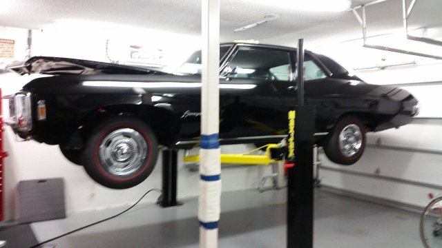

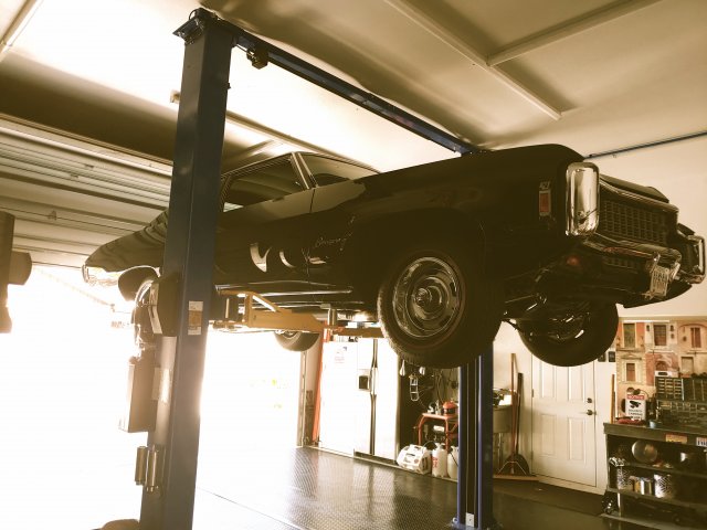

There is nothing better then a two post for car repair. You can get some at a great price
Yet I use the 4-post 10 to one compared to the 2-post.
Guess I'm just backwards, as usual.

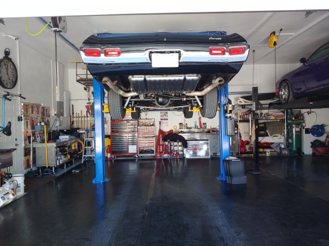

As you can see my four post has the Biscayne on it so a lot more work to make use of it.

I much prefer 4-posts, for the stability. I’ve seen one too many two-posts teeter the vehicle. Which is why I’m looking at these platform styles.
Having owned both style of lifts(two post,Four post) they both teeter a little most of the four posts are made to move so not bolted to the floor. I have had two two post lifts and I just cut a two foot by 8 foot section of my garage out and poured 6 inch thick slab there for the lift. The second one was a new garage so the whole floor was 6 inches thick. I used to live in Arizona and the house next door had a four post outside on his driveway.Only worked on cars at night out there. Way to hot
Since I don't own a Biscayne, that's not a problem for me. The 4-post is always available.
On the other hand, there's usually a Ram 3500 parked "in" the 2-post. But even if that spot was empty, it's so much quicker to drive up on the 4-post and hit the button than it is to get all four pads on the 2-post situated just right, and at the correct height.
Got the 2-post first and thought it'd be all I'd ever want/need, but as mentioned, it's the cheapy 4-post that gets used the most, by far.

Dang - nice! Is that a real 427 Biscayne? '68?
